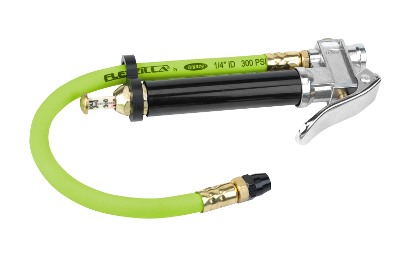

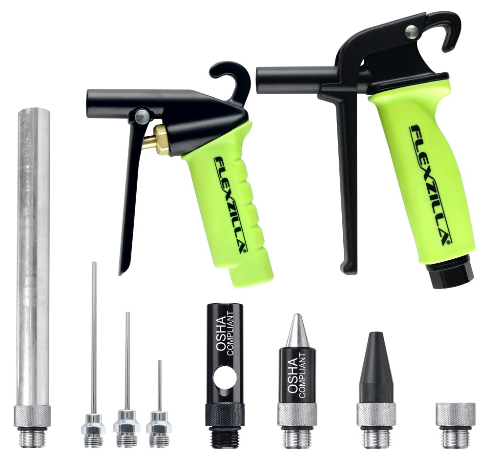

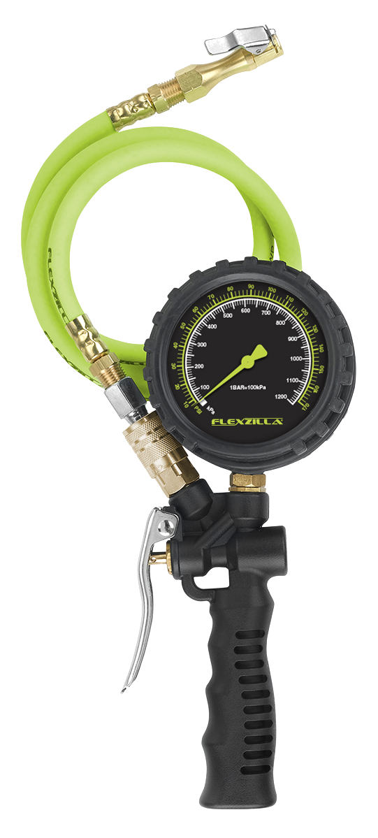

    A hose long enough for the tractor is what I wanted. Some attachments.
    FLEXILLA HGH2-FZ
    3/8x50’
    See the website. Never Kink.
    Attachments available also
    85BCAEFD-C777-45E3-9ECD-CE34BA6970BD.jpeg 1CF5E9DE-91D9-47A4-8A63-CFD8DE2D4961.png
    I found one at PETRO/TA. One isn’t limited to what is shown as to attachments. I also have use for this at home. Swap out gladhand end, etc.

    Cut the end off and get the Milton S693 lock on chuck and splice it in with a hose clamp and a NPT adapter. Or if you have one like pictured above, just thread it on. It will lock on either direction, sometimes you may have to rotate it a little. Worse case you forget about it and it inflates the tire to whatever the governor cutoff is, then just depress the needle and lower it back down to 100-110psi.
