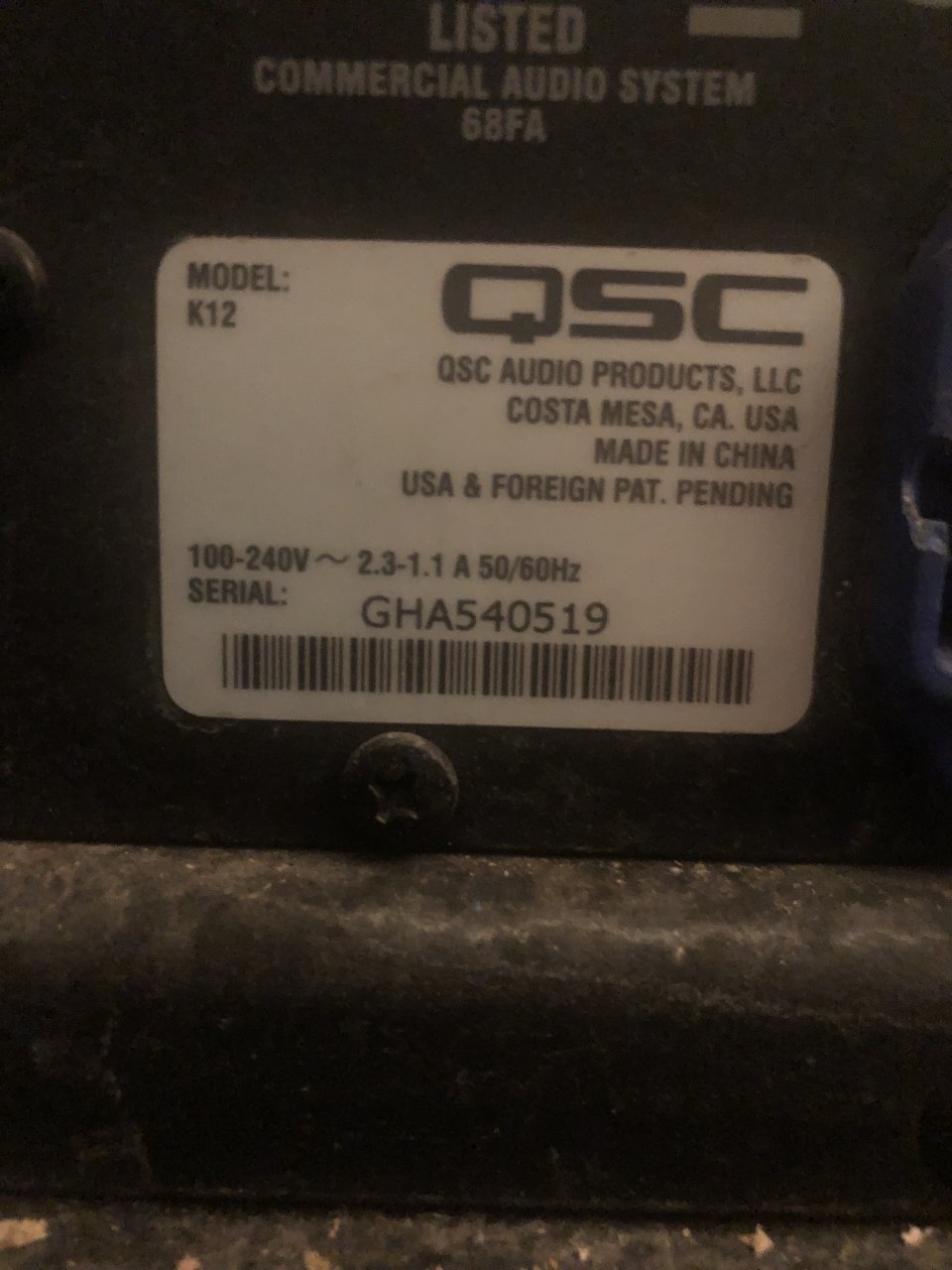

    The QSC specs are here.
    What I’m trying to figure out is if it’s 2.2 amp draw at full power?

    I checked that QSC 1000 ))) common men it's 2000w self powered speaker. :) save your hearing, it's not for truck..
