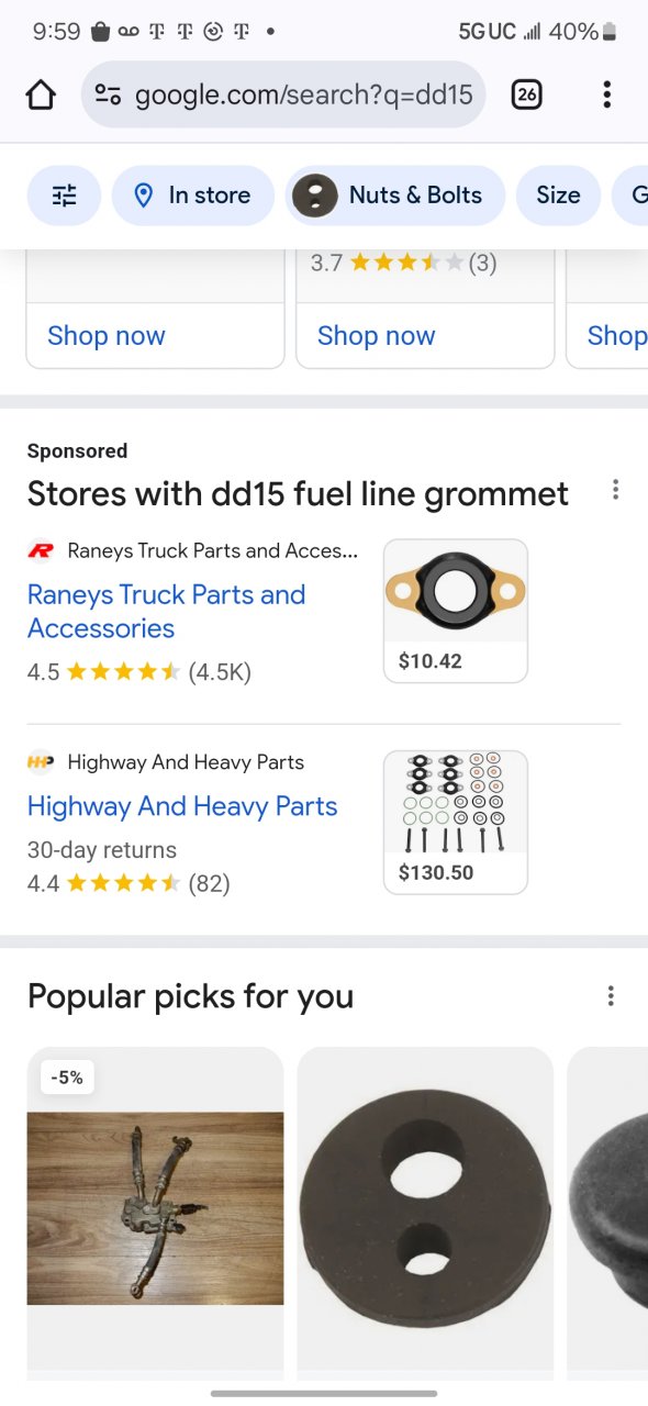

    That is barely a ‘seepage’. Not worth the hassle of trying to repair something that is not broke.
  9. 77fib77
    77fib77 Road Train Member
    11,294
    73,332
    Jul 7, 2010
    St Louis
    It's a grommet. They were like $18 at FL 4 years ago. If you change them you need to disconnect the fuel line. The fuel line pushes through the rubber gasket. If i member right. Your supposed to change the metal fuel line i didn't. You need a torque wrench to do it correctly. You can strip where the bolts go into. I believe where the bolts go into the "riser" is aluminum. So torque specs are around? ft-lbs. The range for the engine was normally 8 ft pounds to 22. If it went into aluminum.

  10. 77fib77
    11,294
    73,332
    Jul 7, 2010
    St Louis
    I bought the "crow foot" thing from snap on when i did it. Amazon should have it too.
    Under $11 for the grommet.

  11. xsetra
    xsetra Road Train Member
    5,160
    7,092
    Aug 21, 2011
    I replaced those a couple months ago. I did all 6, only 2 were weeping. Those bolts only torque around 7.5 ftlbs.
    I was advised not to over tighten because they will strip out easy.
    I don't like oil leaks, so I fixed. The mechanic said it was just nuisance weep. Not critical to fix, BUT the weep will get worse over time.
    You can reuse the individual injector fuel lines. It is the 2 High pressure fuel rail lines you don't reuse.
    Also, you need a special socket to remove.
    DD 15 - Section 35.9 Fuel Rail - Detroit Diesel Engine Troubleshooting
    Good luck.
