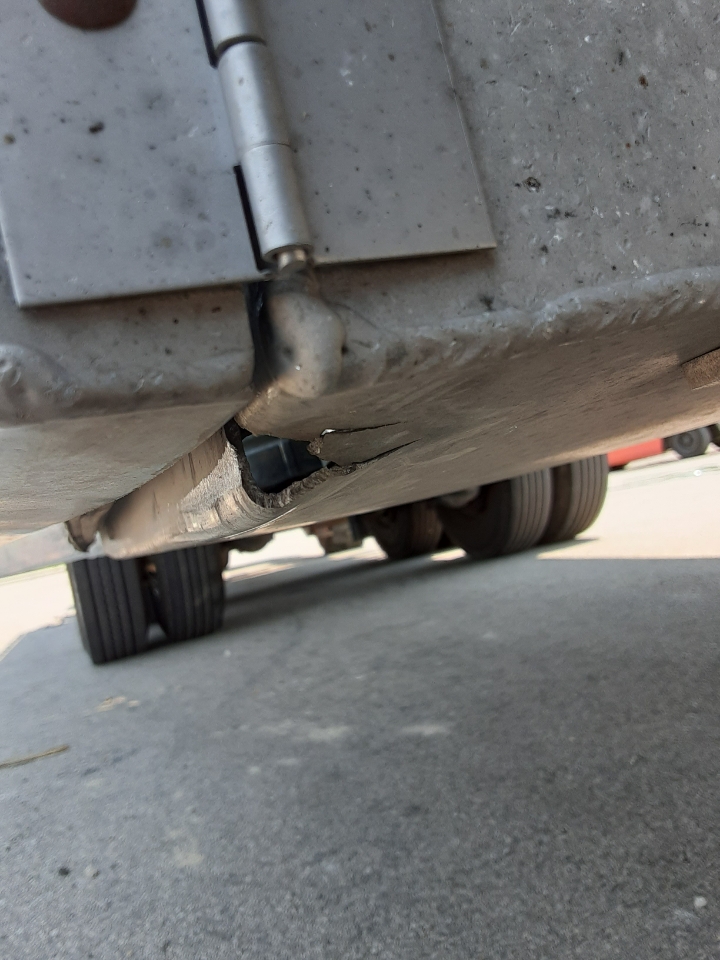

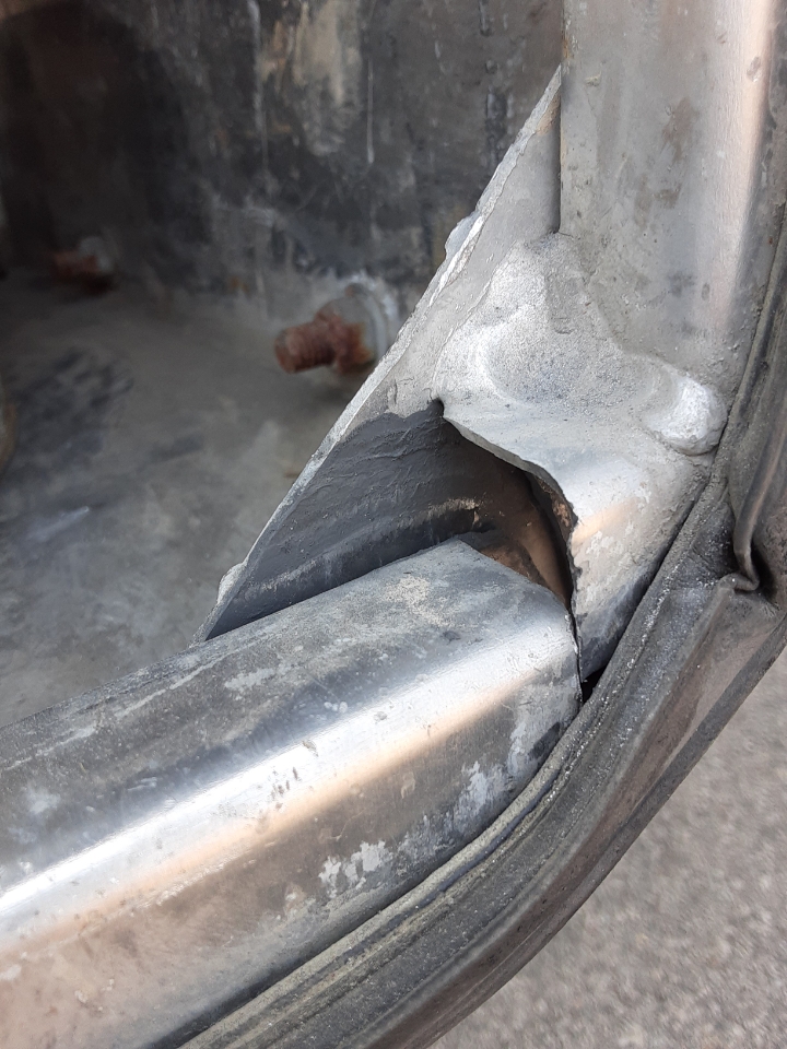

    This is what happened to my box after about a year and a half of use. But I had something like 20 chains riding in that thing, plus all my straps. Way too much weight. I was storing the chains in two 8 gallon stainless steel trash cans, which did a nice job of containing them but centered all the weight on one area. Oops. I can see how the method described by skallagrime would at least take the weight and spread it out evenly.

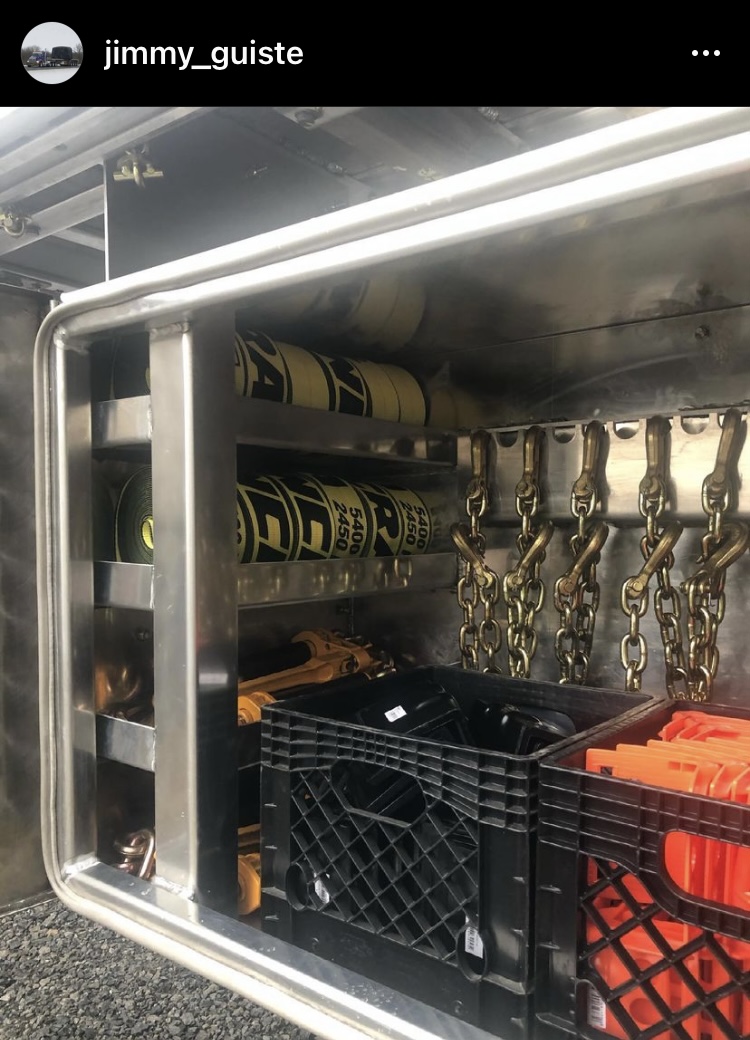

    7CF13D33-6796-4D96-B9CE-566DF8CDD4DB.jpeg @Dadetrucking305
    here is a setup I saw today once you get ramps (if you do) I like that dunnage rack. He has one on both sides.

    Yep, if you note, the face of the box is bowed down causing door issues as well, id wager that happened long before the break happened, gotta keep the weight towards the back of the box where the back can act as a full height gusset too

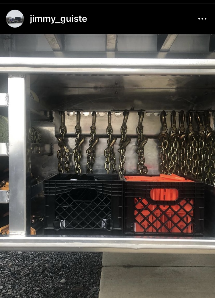

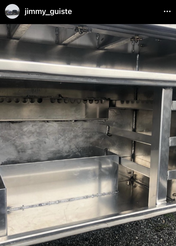

    If I’m spending someone else’s money this would be a great setup. His boxes are much taller then yours though. I’ve also seen guys take rectangle square tube to make pockets for each chain. 7BB35D66-738B-41F7-8B5F-0DF9FB273813.jpeg BA44836A-5EB3-4A8D-ADA4-E6F7B8DA4EA8.jpeg 880FF1FB-90B6-4B94-BC5A-DB277191C6DC.jpeg F227FEB8-C794-432F-8C00-A03EA386A254.jpeg
    I used 4” pvc drainage pipe for my chains in my headache rack. Works great with my ratchet binders stored above on a rack. image.jpg
