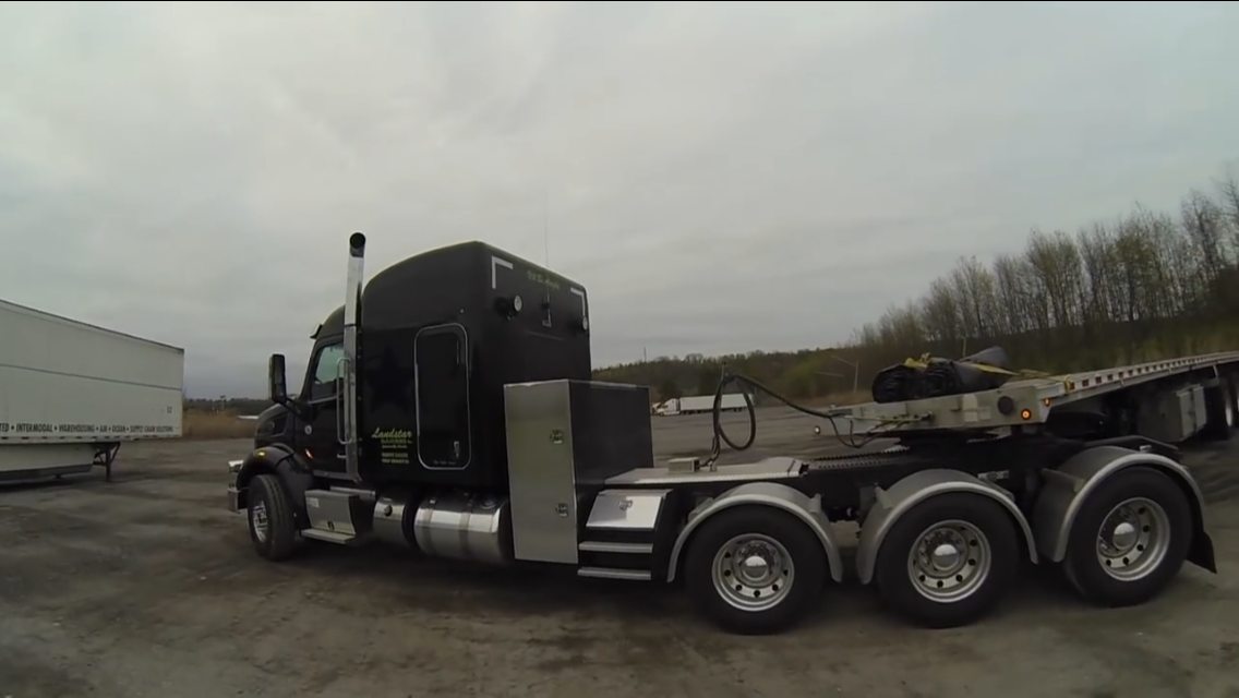

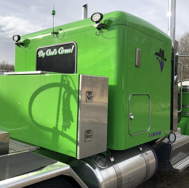

    I've always loved how that guy in the bottom picture has his box. I really wanted to do that on my next truck but just can't spare that much wheelbase. Already have enough problems with length permits and avoiding escorts.

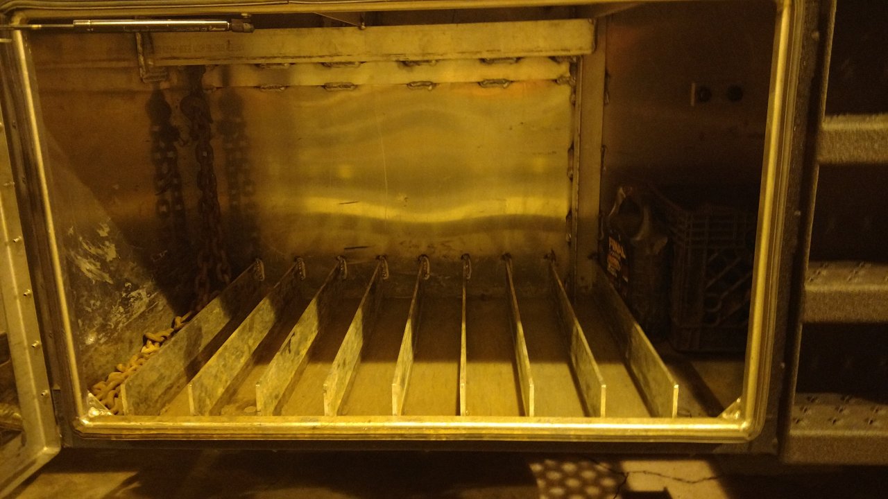

    I have all of my chains on a box on the drivers side low to the ground now but it's closer to a standard side box. 24x24 with hangers at the back. It seemed like a good idea 5 years ago when they were built. Having to kneel down on the ground and bend over to reach back into the box sucks though. Especially if it's a muddy job site.
    I can fit 3 chains in each of the dividers along the bottom. I keep 16 10ft chains and 12 binders in there.
    I'm going back to a standard headache rack for my next truck. Trying to get one of those roll up door racks if I can find one in time.

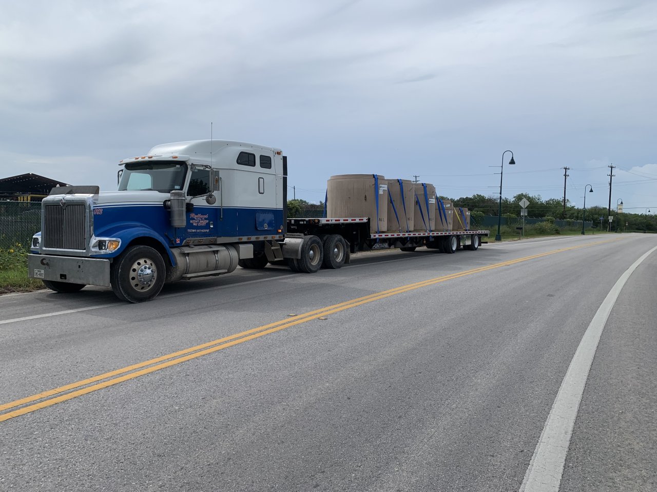

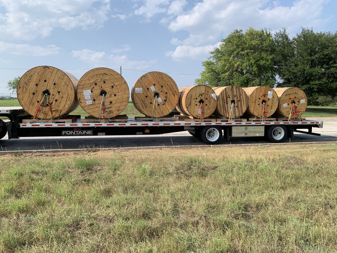

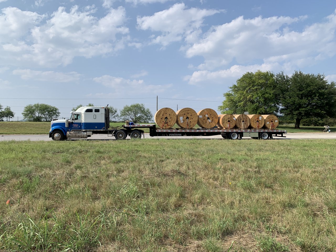

    The first load of precast sewer drains I x’d the straps over.How’s the second load of fiber reels look to y’all? Did I load the trailer right or should I have spread the bigger reels out more?

    ive been meaning to stop being lazy and move some of my 1/2” chains into one of the boxes and out of the rack.
    I can’t speak highly enough of having access to everything from the ground. Saves so many trips up the steps or a hop onto the trailer.

    I have an opinion but I will let one of the experts answer first so I can find out how wrong I am before i post it.
    What are those silver things? Are they banded to the pallets?

    Metal bands.

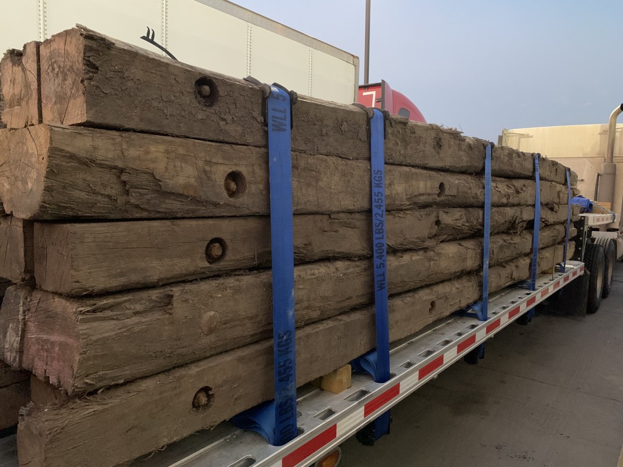

    Would y’all have put edge protectors on these mats? The edges were rough so I put them on.Another driver said they weren’t necessary.
