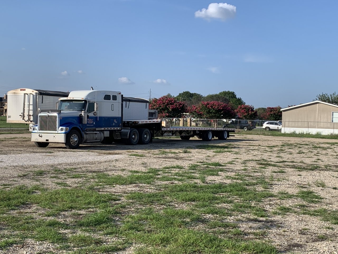

    Not a great pic because the truck is dirty and it’s from a distance.But I’ll get some more once it’s clean and box is installed.

    Does the back axle slide…?

    No,it’s fixed.
