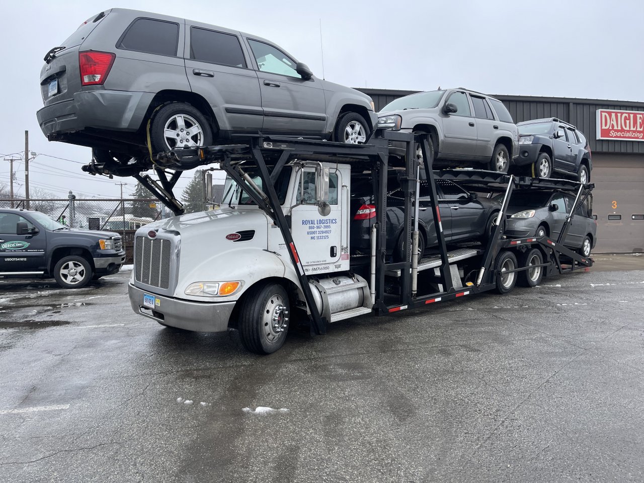

    3FA66E95-F2A9-49AC-A011-BE69692B4CEC.jpeg 03CFD864-5DB8-4623-A3AA-4DF901E0B387.jpeg EBE9DAD7-FFF3-473E-B38C-BFF83083FA87.jpeg Hi.My name is Kay from CT.l’m new to this platform.l own a 5 pack car hauler 08 peterbilt 340 class B.l have a little problem and a friend suggested I join this platform,there are good experience people here that can help.My problem is,sometimes when I load the truck,it sways a lot especially when I put an suv on top of the cab,to a pointy that I can only do 40 miles per hour to stop it a bit.l have change front shocks and few other things and it’s still does the same thing.When l load just cars I do t fell it much.Any ideas??This is a picture of it loaded.Please help.Thanks
  3. AModelCat
    29,108
    157,751
    What have you got for rear suspension?
  4. Royalllc
    Royalllc Bobtail Member
    2
    Feb 16, 2021
    Thanks for the response.l have air suspension in the rear
  5. Lucky12
    Lucky12 Medium Load Member
    600
    2,297
    Nov 24, 2019
    Your center of gravity is getting too high. Be careful because you might lay it over.
  6. Lucky12
    600
    2,297
    Nov 24, 2019
    Also, look at the wheelbase distance on your rig vs the amount of cantilever (overhang) both front and rear. Ideally you would load the higher center of gravity vehicles on the bottom if possible.
    haycarter, Doealex and Badmon Thank this.
  7. Hammer166
    7,448
    26,956
    Aug 18, 2007
    ~8600+' and loving it!
    Also, make sure you keep the weight as far back as possible. It's quite likely the steer is overloaded, what your describing is exactly what happens with a stinger if you drop the trailer while loaded. A block to the shop was too far, it was like driving a boxcar.
  8. Saltyoldone
    Saltyoldone Light Load Member
    181
    511
    Jun 16, 2019
    Boise
    A 5500lbs suv over the front wheels will make any rollback unstable. (and over 14’ tall)
    I can only load something under 3000lbs up there and I’ll still drive 45 or less
    haycarter, Doealex and Flint1 Thank this.
  9. AModelCat
    29,108
    157,751
    Air ride isn't doing you any favours with high center of gravity loads.
  10. jamespmack
    19,968
    215,511
    Might be worth weighing each axle to see if your overloading a axle.
  11. Flint1
    Flint1 Road Train Member
    1,142
    9,784
    Sep 4, 2019
    Alberta
    4 mid size + SUVs and a minivan, I'd suspect an overload. Scale it to be sure before someone else does it for you.
