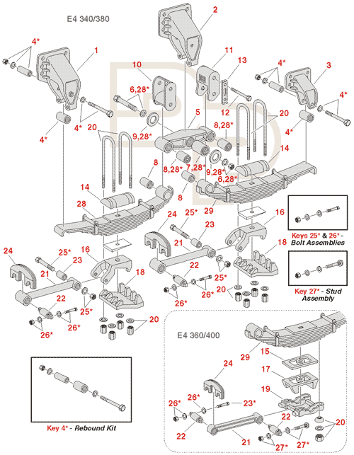

    Hendrickson E4 had shackles.
    items 10-11 are shackles..
    I'm probably showing My age by posting this..LOL
    Toomanybikes and rambler Thank this.

    thanks haycarter, I've never seen it but then I'm a young man.. I wasnt thinking of equalizer hangers but in term of a shackle on the opposite end of the spring like on a steering axle. Blonde moment. What is the rating on that E4?
