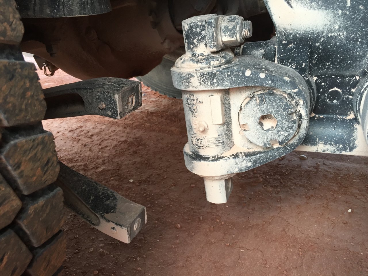

    Two different times I've been on the side of a lease road with broken suspension on my old KW. Both times it was the studs on the torsion arms that broke and let the axle swing around. If I'd been on the highway, there's no doubt in my mind I'd have been in the ditch in a quick hurry with a fastness. Fortunately, both times it happened, I was crawling and was able to control the truck.
    If you look closely, you'll see that the studs broke off flush. You'll also notice that they are pretty dirty where they broke, indicating that they had both been cracked for quite some time. Now, I own this truck, and I drive it every day. I trust it to feed my family. I do my own service/mechanic work. If you think I don't pre-trip, think again. I'm all over and all under this truck all the time. There is no way you could have caught those cracks on a pre-trip because they are in a place that can't be seen.
    What I'm getting at is sometimes things break and there's just no way a pre-trip can catch it. Believe me, I'd much rather catch it ahead of time and replace a couple of cheap bolt studs at my leisure, than to get out on a job, break down, miss several loads, and spend hundreds of dollars to get back going again.
    Now I'm not taking the OP's side here. He did say the truck had been making a popping sound. That's grounds for getting on the ground and finding out what is going on. If I can't find it right away, the truck doesn't go anywhere until I get it figured out. If the shop "fixed" it, but it still was popping, it would be right back in the shop.
    By the way, I have since replaced the old AG200 suspension with the AG400, which is all one piece. No small pieces to break.
