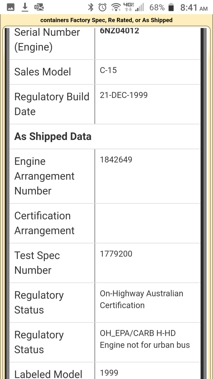

    First 4000 6NZ's were 99 model, I posted the last 99 serial # on here in the past. Screenshot_20210409-084153.png
    black_dog106 and 062 Thank this.

    I'm curious. This one is Australian. All I've seen, and I'm not a cat guy who knows how to access this particular database, but I'll I've seen from Cat websites is that the C15 was a 2000 my. Is it possible that all the 99 were Australian?

    It's not Australian, it meets both regs. Line below shows On highway EPA. Here is ECM download when it was overhauled by a MHC KW dealer in KC. Screenshot_20210409-142256.png Screenshot_20210409-142323.png
    black_dog106 and Bean Jr. Thank this.
