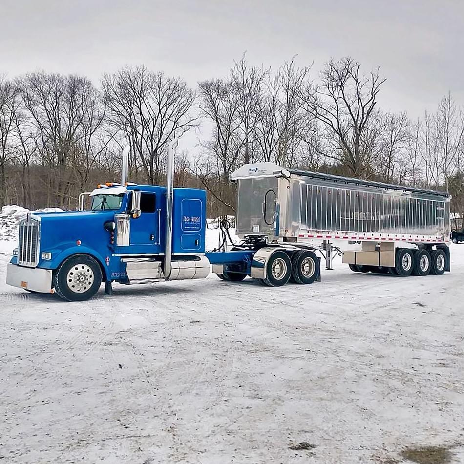

    Picture from local trailer dealership

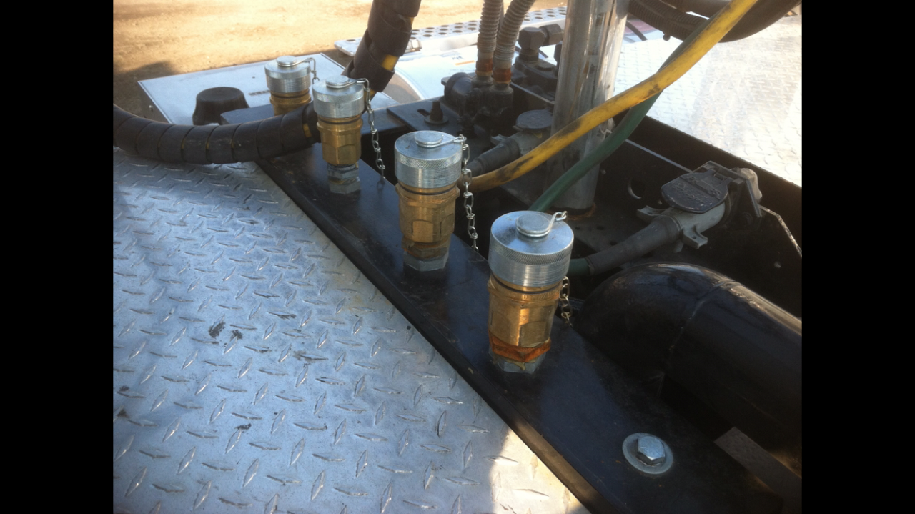

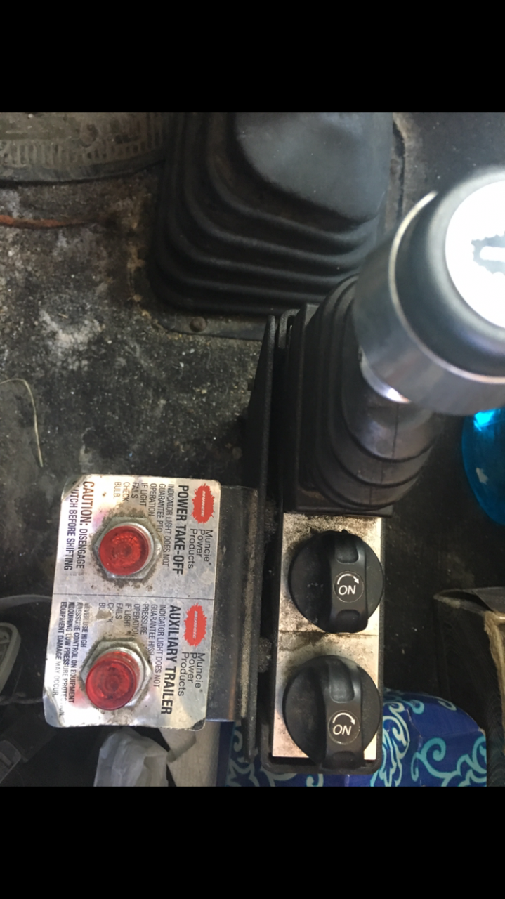

    Never pulled a dump with my current truck.... but its pretty much set up for it.
    5A0305EB-118F-4C1F-890E-D431582A3B65.png 578E1609-D249-4F8A-BE2E-92F65459AB62.png
    2 ptos.... 1 with cooler and small reservoir for a product pump on a propane type trailer for example. And the other with 65 gal of oil for dump trailer , and a return line just in case......

    Could you run a live-bottom, walking floor, or belt trailer with that setup, if you were so inclined?
