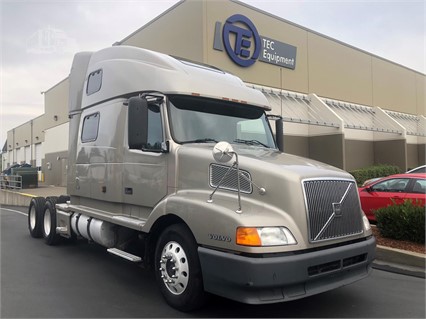

    They will take 10k on this truck. Front cover is leaking, bell housing too. Transmission leaks ,needs a cac, some rust on the floor. But has a solid base to start with.
