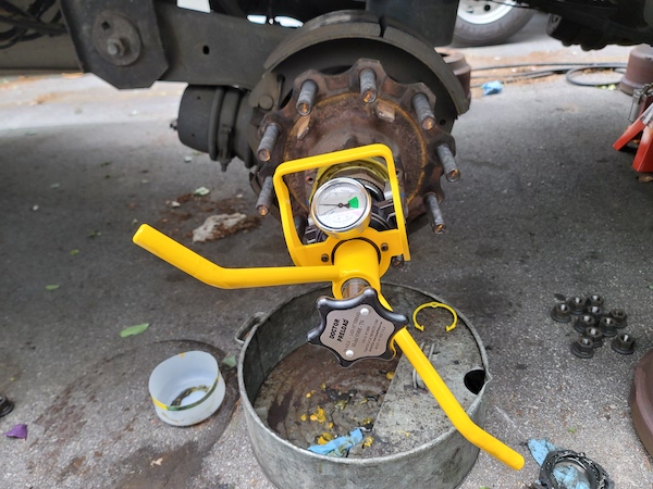

    Dr. Preload master race checking in. This system uses a Temper brand nut, which is similar (and cost about the same) to the Stemco nut with the inside locking ring but with a relief on the back to clear the press arms. Preload is exactly right every time. The tool pulls on the spindle and the arms press against the outer bearing inner race. The picture of the tool in use is obviously one of my trailer hubs, but they do make them to fit steer and driver hubs. @ProfessionalNoticer I'm unsure of the range of coverage, you'd have to call about older or less common spindles. Downside the tools run $500 - 700 or so, and fit only one spindle type. You'd have to buy 3 tools to cover a truck and trailer. Or find a shop that has them and pay them to do it. Upside is: if my trailer tires last an extra year, the tool is paid for and then some. I also have two of the same truck/trailer, so the cost is spread out and more useful.
    I finally got through doing all hubs on both my trailers. Massive improvement in ride quality on both, along with a tiny 0.2 mpg gain in fuel economy. I also bought the tool to fit steer hubs, but have not had time to tackle those just yet. I've had a productive couple months with other maintenance chores, so the steer axle seals and bearing preload are steadily moving up the priority list. No indications of issues with the drives at the moment, so I have not bought the system for those yet.

    Are you a salesman for this system because it sure sounds like it.
    I can’t see the preload or lack of making any difference in tire wear or ride unless they’re massively loose.
    Might be able to sell me on the extra mpg.
