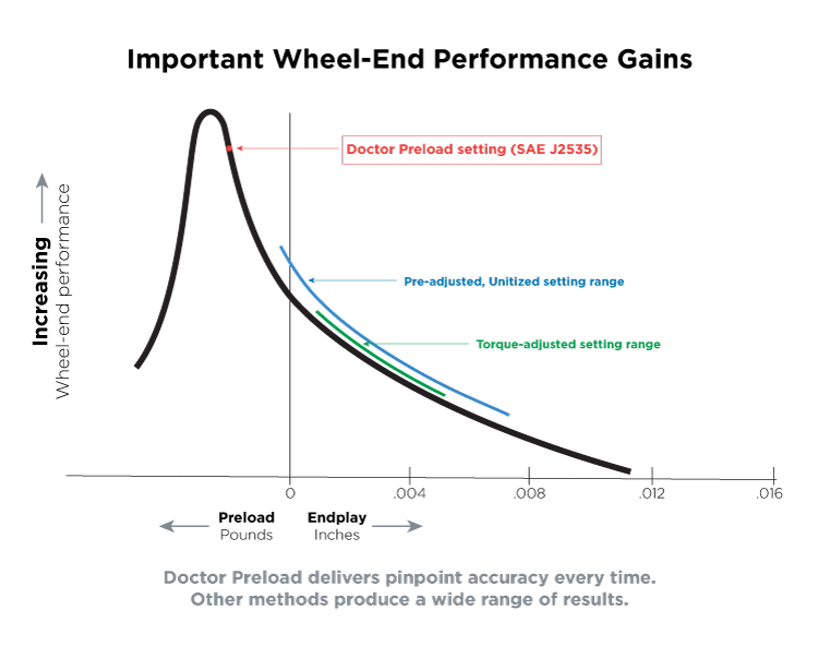

    Zero endplay. The standard is "light preload" which is a hair past zero endplay. They don't say it, but my feeling is that bearing manufacturers go with the endplay standard they have, since once you reach zero, endplay obviously cannot be used to estimate preload, and a tiny bit loose is better than too tight. Also worth consideration, the bearing/hub companies only need to outlive their warranty and never have to buy tires. So not exactly any financial obligation to make them perfect. I think the only way to measure this without an actual press device would be a dial torque wrench to measure turning effort. Of course bearing condition, dirt contamination, etc would all affect the accuracy of this. This graphic is taken from their material and illustrates the comparison of the various methods. I embedded a link if you want to read the entire article.
