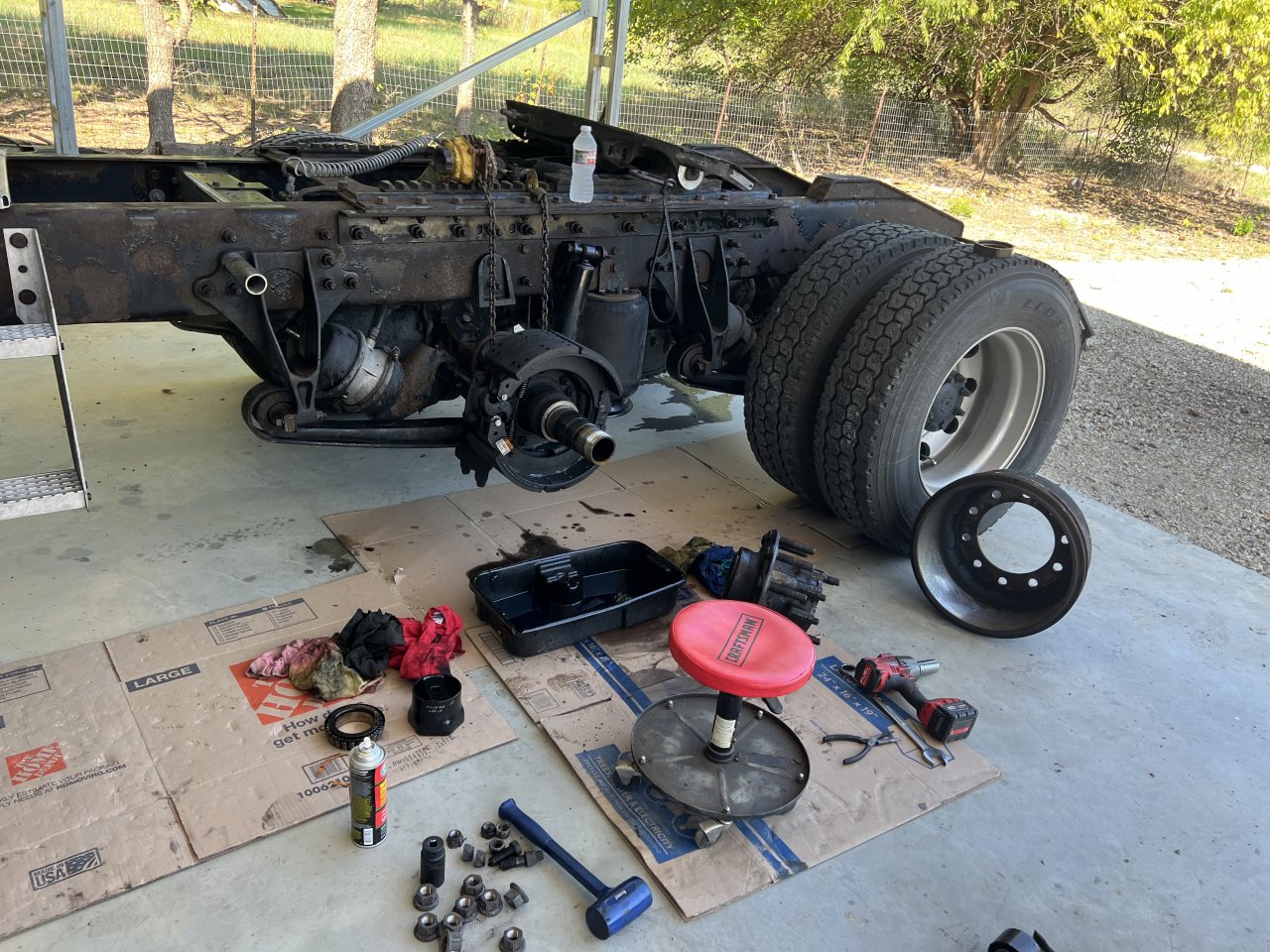

    Just a funny afterthought, I searched the SAE spec referenced on the chart. You have to pay to see it so I did not go further. However, one of the results that came up was a Meritor document pitching their wheel bearing adjustment system, which is Dr Preload. This is neither here nor there, but interesting as the Dr Preload guy never mentioned any tie-ins with Meritor, despite me telling him my trucks had Meritor axles. Seems like it would have been ideal sales leverage.

    Sounds like Meritor may have bought them out after your conversation with him? I like the idea of the Dr. Preload but I get it pretty close to perfect following the TMC guidelines and verify that with a gauge per their instructions.

    Who knows? May have been a licensing or co-development deal, possibly a spin-off company. The linked pdf has a 2015 date on it and I placed my order 5 months ago.
    ETA: I never heard of it until stumbling across a mention of it in the 9+ mpg FB group maybe a year ago. To be fair, I'm not on FB much at all the past few years, so it probably had been mentioned many times before and I never seen it. Also haven't been to MATS since 4-5 years ago or I'd have seen them there.

    Ha! I jinxed you! At least you got to handle it at home though instead of getting bent over by a shop while on the road.
