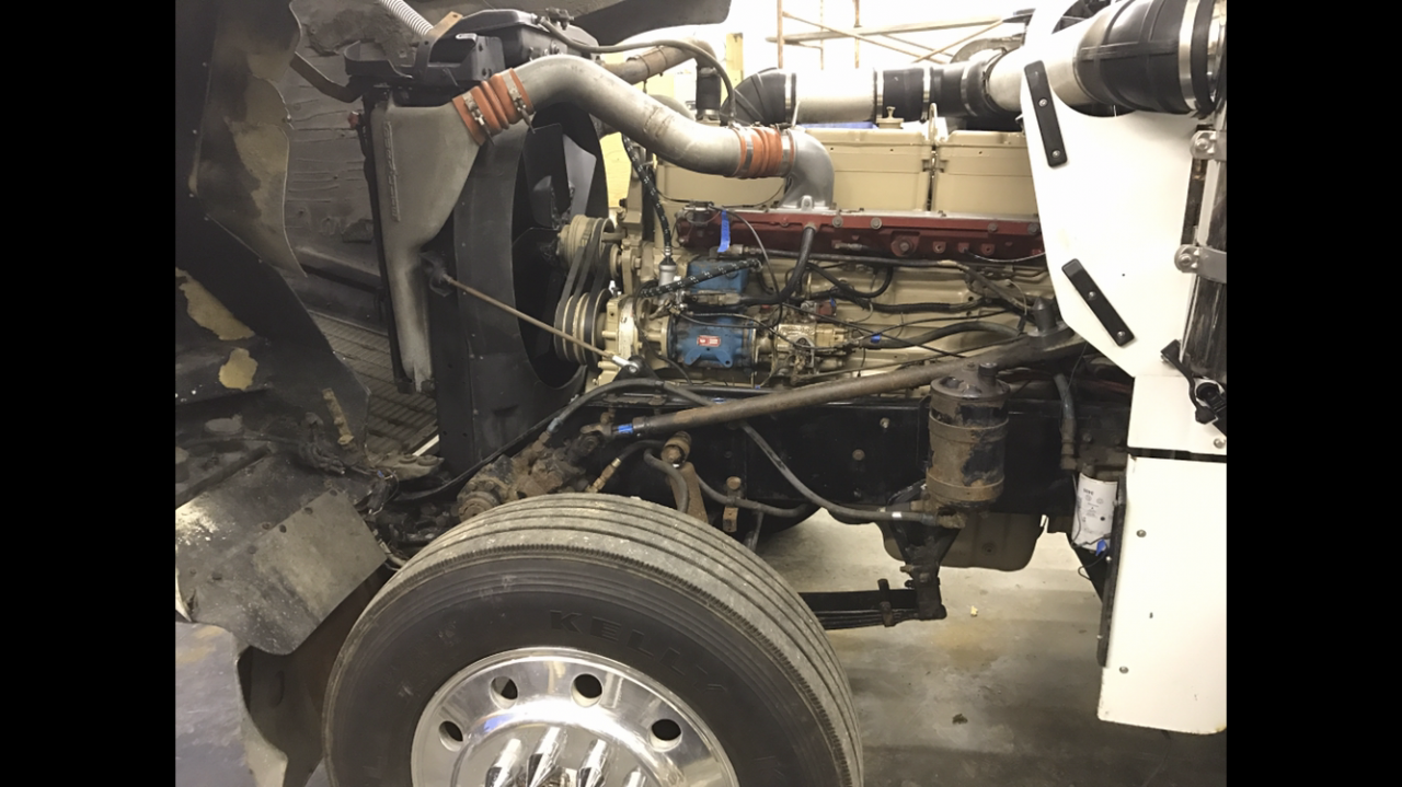

    Yes Sir it’s a N14 intake with a N14 525 HT60. When I was driving for Pop back in the 80’s the biggest thing he owned was a few “HOT” Big Cams, a KT & really HOT 3406 lol. All

    No problem bolting the intake up and getting rid of the after cooler?
    I saved a pallet of N 14 parts, I have the intake and exhaust and even a turbo (not sure which one) but I would want a new one anyway, and would have to buy an air to air. I have a nice A model that currently has a big cam 111 that could use freshening up, I have been on the fence between inframing it or just going with an electronic engine and newer tranny.
    A stought big cam would be cool, if I could hold with the stock 550's.
    How does yours pull compared to say a 525 N 14?

    The intake will bolt right to it no problem.
    I will let @OLDSKOOLERnWV tell you about his engine, but I know a bit about that monster.
    As far as comparing his engine to 525 horsepower or 550 horsepower...
    If they lined up side-by-side and pulled a gigantic mountain, he would just take off and would be rapidly out of sight.
    That big cam has so much more, it's unfair to compare them.

    I don't know what big cam 525 will do against say a Detriot 60 515...
    The brake hp ratings should not even be the same. Those old cams should develop more.

    Old schooler os that a b model kw that big cam is in.
    Besides the N14 intake and turbo, what else have you one to the engine, I am assuming pump and injector work.
    If I go this route, it will be starting out as a big cam 111 400 (not sure on cpl, but can change if need be anyway)
    Also If I go with the big cam, I would like it to pull, but don't want to make it so hot it doesn't stay together.
    We have some steep grades here and the guys that juice their cats up too much have a hard time keeping them together. That is the E's C 15 and 16's and the acerts, it seems like the hot B models hang in their pretty well, but even they will have warped cranks come bearing time, and there is no lace in Alaska I have found to straighten cranks or line bore blocks.
