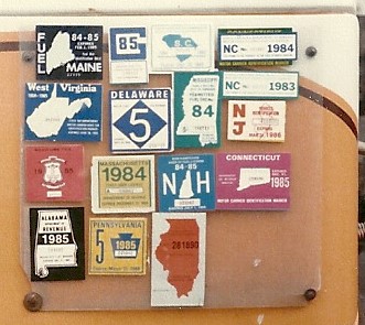

  8. clausland
    clausland Road Train Member
    1,933
    11,067
    Dec 5, 2014
    North Woods
    Before IFTA & IRP, we had stickers and license plates plastered all over the cab....Some states wanted them on the driver's door, some on the pax door, some on the front, OH wanted there's in the lower right side of the windshield and on & on....

    Daum! U been at this awhile. It's so easy for us now. Automatic trucks,ifta,pre pass,cell phones,gps...
