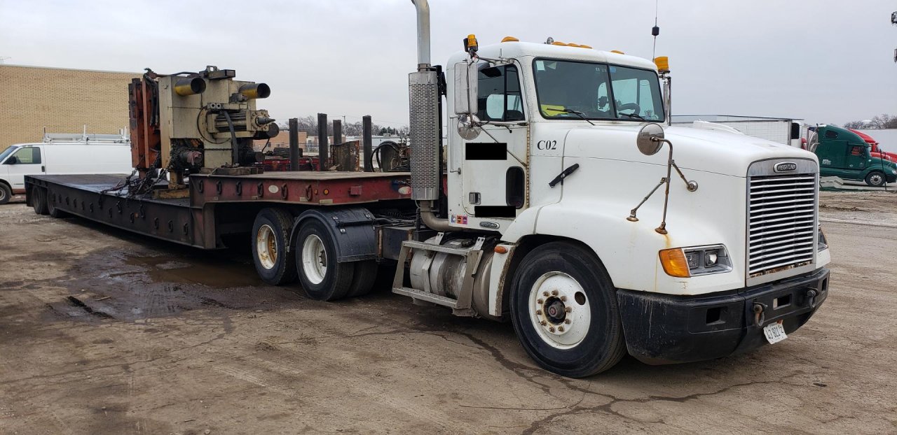

    Right now I have a 2 axle RGN Trailking TK60MG. I am trawling auctions to find a good deal on a 3 or 4 axle trailer with a hydraulic neck. (I have a regular truck with tandem rear axle and a wet kit).
    I know that my quarterly permit allows me up to 120k lbs on 6 axles. It does not say anything about 7 axles and I have not found much info on this.
    My questions is how much would I be permitted to haul on 7 axles with a 4 axle trailer. I would suppose that I have to get a superload permit for every load over 120k?
    The reason for all this question is to decide if I get any advantage at all from owning a trailer to which I can add/remove a 4th axle. Maybe I should just settle for a cheaper to buy a used 3 axle RGN trailer and not spend anything on the 4th axle option?

    I bought my 2 axle RGN for 12.5k at an auction...
    But back to my original question... Would having a removable 4th axle, and not simply 3, axles, confer some kind of advantage to me realistically?

    Kind of hard to balance weight to max a 4 axle, unless you haul loads that are less than15 ft long.. you can’t load over the axles like on a step so you’ll get heavy in the front real easy.
    nikmirbre and ichudov Thank this.

    Thank you. I kind of agree with you and I think that without a Jeep there's no way to load that properly. I would just look for a 3-axle

    That doesn’t make sense, I can max out my 8 axle no problem with a variety of machines.

    Well it’s a hard to answer without knowing what you’re planning to haul.

    I am a private carrier. I haul my own forklifts, the heaviest of which could be 66-67,000 lbs if I put a boom on it. With forks and not the boom, this forklift is 61,000. I also haul scrap metal or other heavy machinery that I buy or get for free. Last piece of scrap metal that was the biggest was also about 60,000 lbs.
    It looks small but it is very heavy. I do not anticipate needing more axles than 6 or 7 at most.

    You should be able to scale 60,000 in Illinois on a tandem tractor and trailer. Even if your tare weight was 50,000 which it won’t be with that little Freightliner you’d still only be 110,000. That little truck and a 35 ton tandem detach you’d be closer to 40,000 empty.
