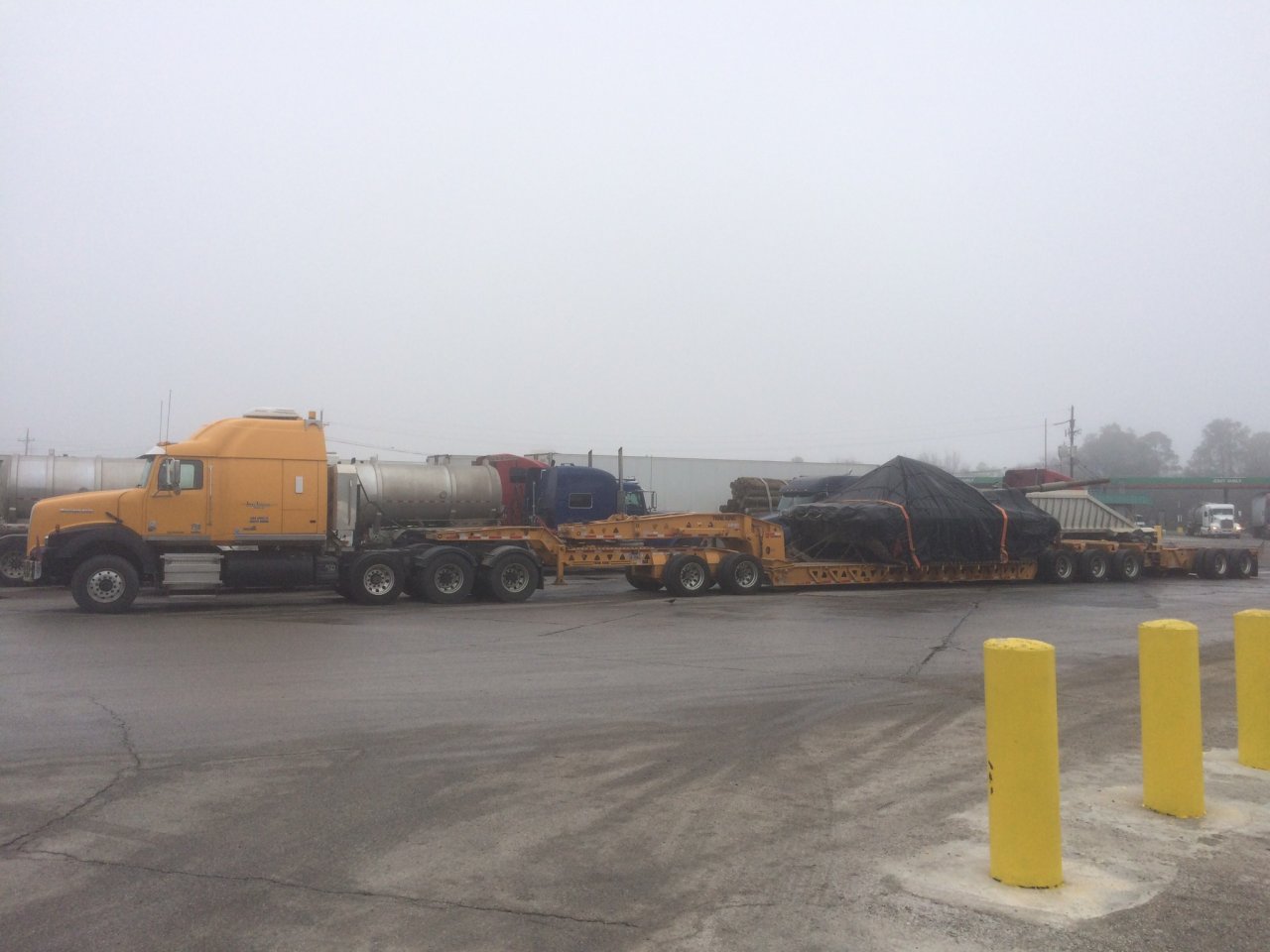

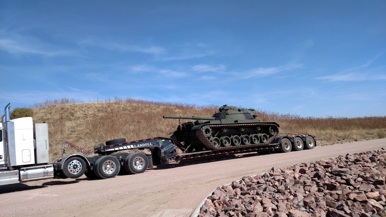

    You should have gone for the stealth look instead -
