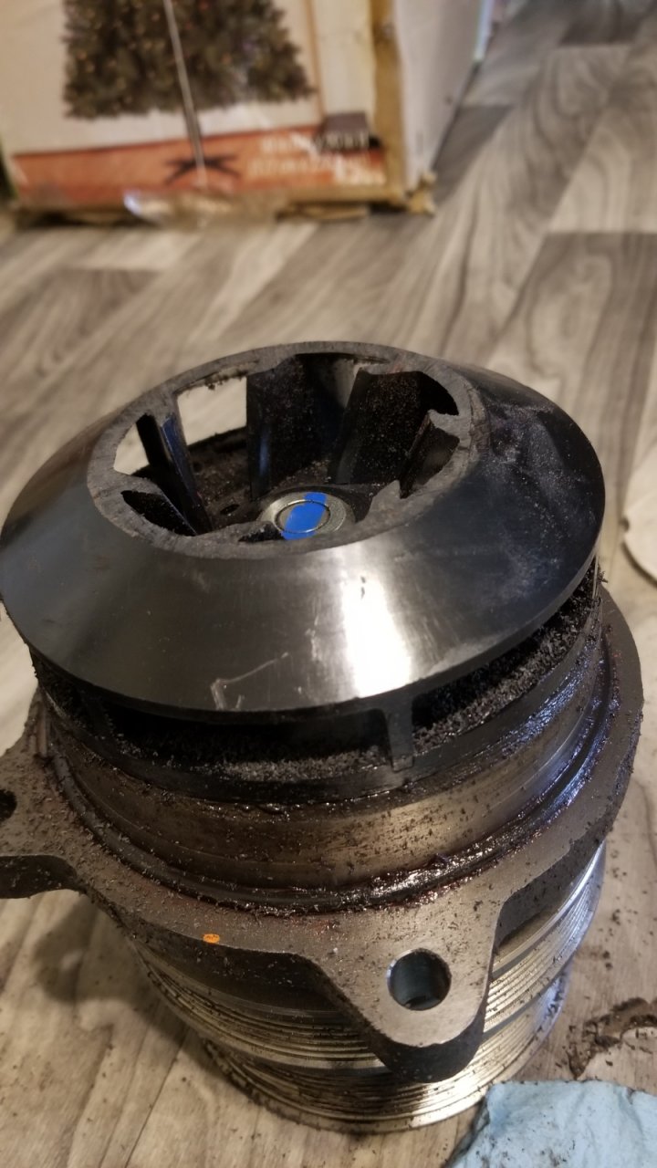

    I bought a new water pump and its been updated. The impeller side has a conical shape to the end of it now and it doesnt fit into the old housing. If i start to finger tighten the bolts then i cannot freely spin the pulley.
    Does anyone have the procedure on pulling the impeller?

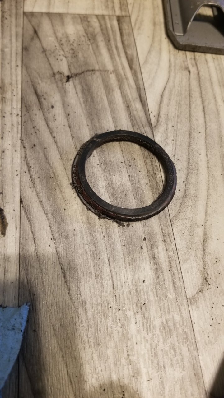

    Resized_20201211_124931(1).jpeg Resized_20201211_124926(1).jpeg 20201211_161119.jpg i just cut it. ‍♂️ now i just cut the conical part off. Cross fingers and sent prayers. Shes warning up now.

    Pretty much the same deal. Wp doesn't come separately from the housing now. I dont have the tools to do the housing because one of the bolts appears to be behind the cs pulley. I dont have the funds to purchase a new cs pulley quite honestly. Also dont have the help to remove the cooler and radiator if i have the tools. So, I cut it. Hopefully that does the trick. She ran just now. Small leak the #### oring poked out the bottom smh. So gotta pull it reseat the o ring if its in good shape or replace it with the old one and see how she does his time. Has a slight squeal to it. Not sure if the belts wet or something else. Guess we'll see in a few.‍♂️
