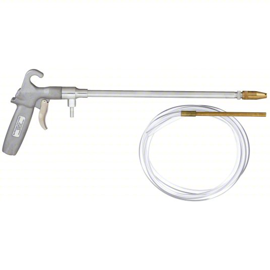

  5. Star Rider
    Star Rider Road Train Member
    1,371
    11,141
    Sep 23, 2019
    Michigan

  10. elliott
    elliott Light Load Member
    102
    30
    Sep 3, 2007
    Great idea. Looks like those guns could squirt enough pressure to flush out of the gallies. Just flood the block and keep flushing. I'll see if I can find one at a hardware store or something.
