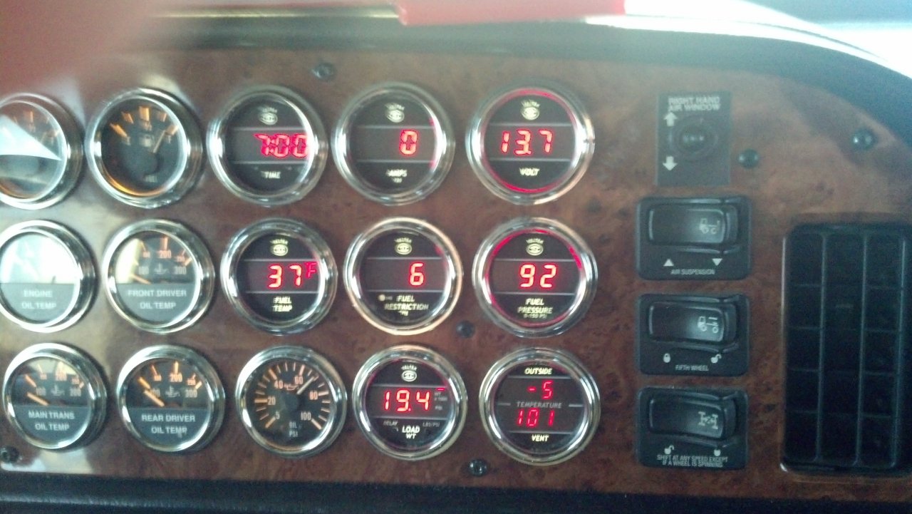

    2013-01-12 17.01.28 (2).jpg 109t_29_general.jpg Get a Teltek water temp gauge and sending unit. Get rid of the inaccurate OEM gauge.
