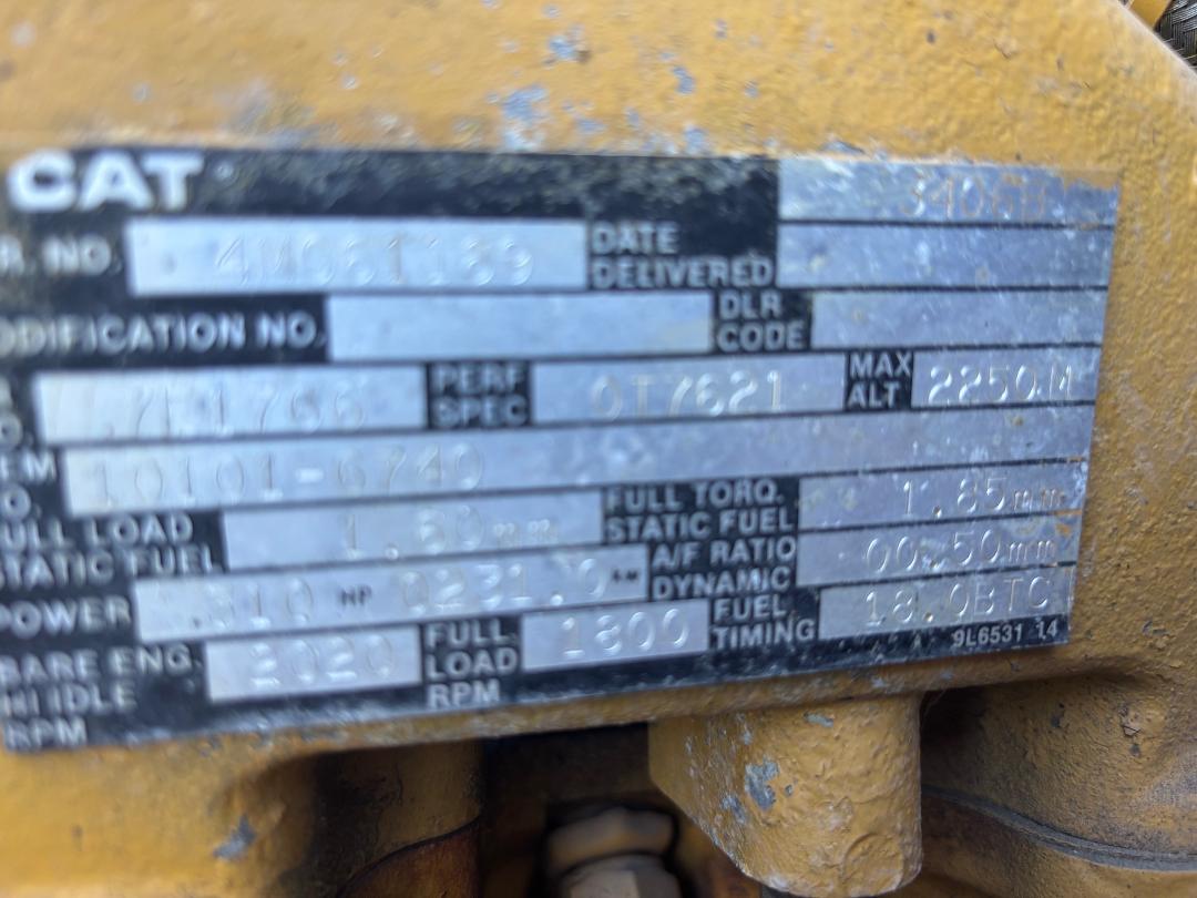

    I found a 3406B 4MG set at 310 hp. How hard would it be to get more HP out of this engine, would parts off of my 3ZJ work toward increasing the horse power. Engine sounds good but I do not have a whole lot more info.
