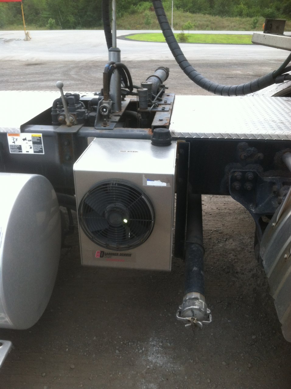

    Our trucks have two. One is for the pto shaft hydraulic pump and the other for a high pressure air pump.

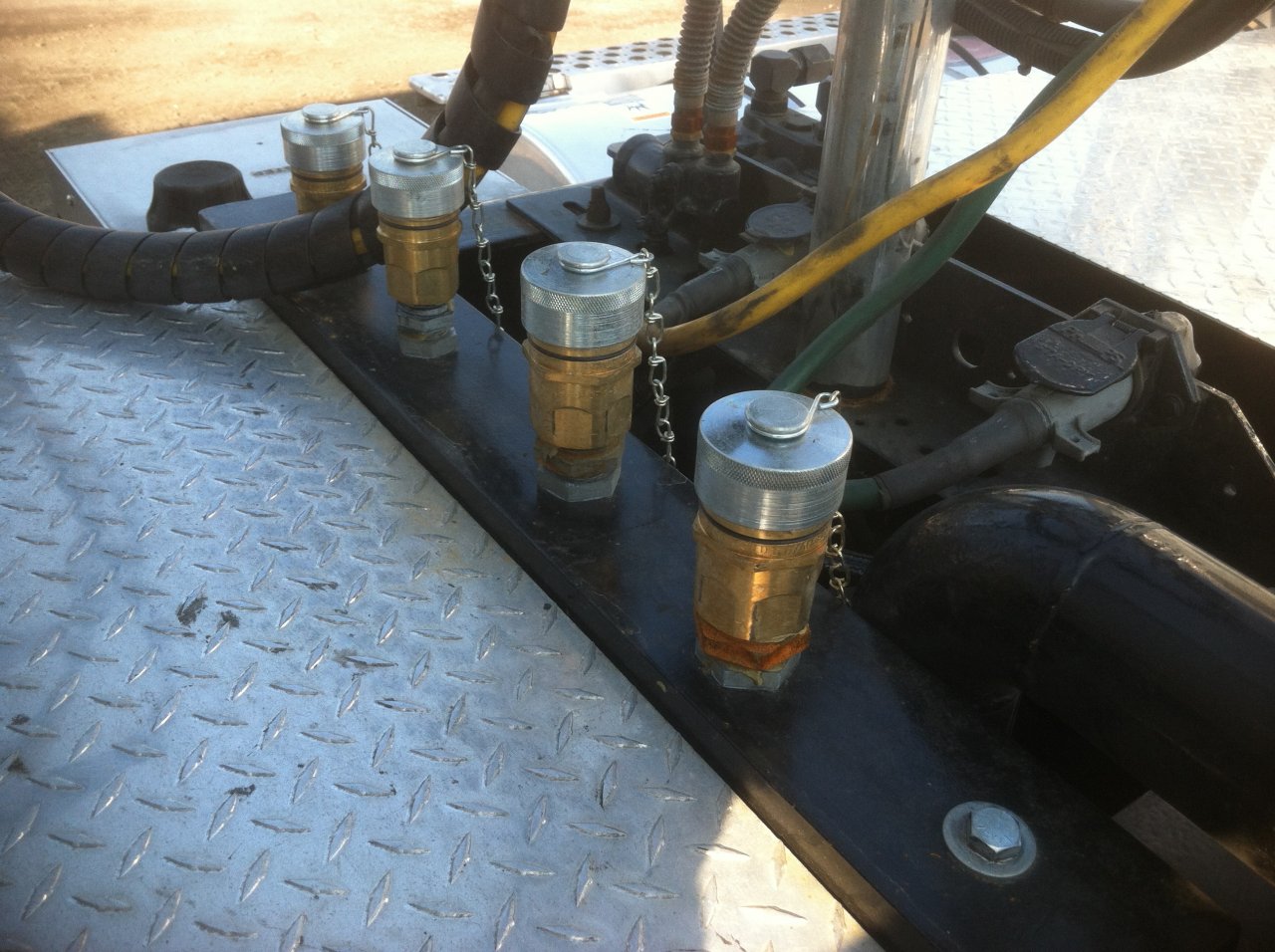

    2 pto’s the only way to fly.......

    BE73991E-A991-4F9B-83C3-6698C6686BA0.jpeg 61CBC17D-B0F0-45E5-96CB-8B57989BAAE0.jpeg
