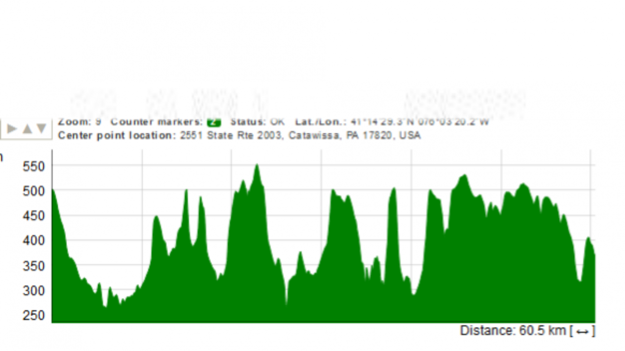

    I had a blast, although the headphones kept falling out of my ears. I need to invest in a nicer pair. Here's a map of the trip. I guess I was wrong about 45 miles. after measuring, it was 37.5 as the crow flies.

    The radio doing the recording on my end was the anytone at-6666 and the radio being recorded was a buddy of mine in a Kenworth W900 and His Radio was the Stryker 955 and he was using a Predator 10-K antenna and I was using a roof Mount Wilson 5000 antenna and when he got off at exit 107 he was down below line of sight and there were several mountains in between us as you can see in this terrain photo.
    Neither one of us were using amplifiers.
    jessejamesdallas Thanks this.

    Yeah I saw the terrain depiction. It, of course, doesn't show exactly how the two communicating antennas are placed relative to all the peaks at any given time, especially since both antennas are moving during the communications and the terrain in between changes accordingly.
    Assuming the antennas are placed at the top of the left and right peaks respectively, then it seems they would have a problem maintaining a line-of-sight configuration just based on the display. But, of course, there probably are a lot of "dips" in the terrain between each of the peaks that might afford LOS path(s) at any given time.
    The whole ground wave theory of RF transmission is interesting and befuddling at the same time, with its various line-of-sight, surface waves, space waves etc all fighting to get through the various conditions that prevail during the efforts to communicate.
    Thanks for the info. You guys achieve distances that seem marvelous to me as a flat-lander. I can see why folks reading about such feats get frustrated and start wondering what they're doing wrong to miss out on what others are doing with their mobile equipment, especially if they are using factory-legal 4-watt radios. Unless, of course, our erratic and undependable friend "Skip" shows up.
