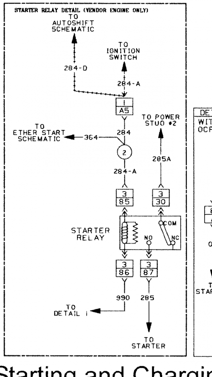

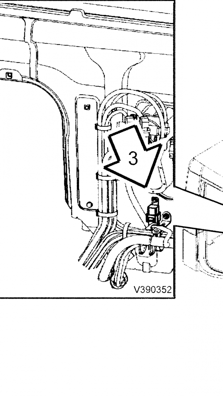

    0BBFB07D-56B4-4F8E-9AE5-E09B3D9939B2.png 4B82B980-6AA8-4E6E-AC06-750700176F8B.png Well it does look like I have a relay... hmm

    What’s going on you all? Thanks for the help; I got the motor started.
    I made my first YouTube video over it. I can’t believe Youtube didn’t have a. N14 starter video
    ... I hooked the new starter up wrong; may have fried my truck starter relay. Replaced the starter relay, hooked the starter up right and, thumbs up
