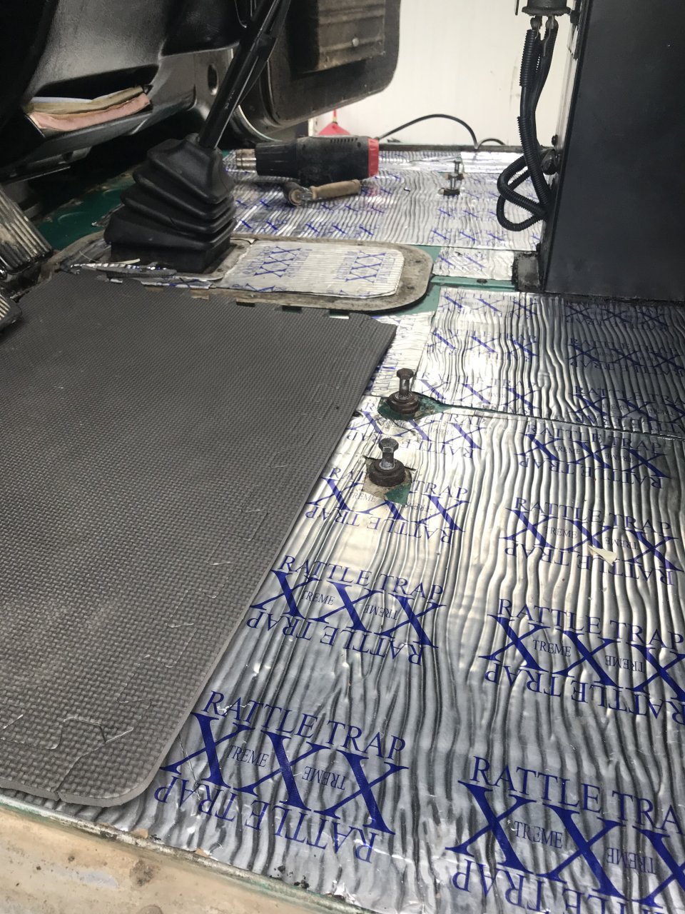

Installed Home Depot floor in my 379

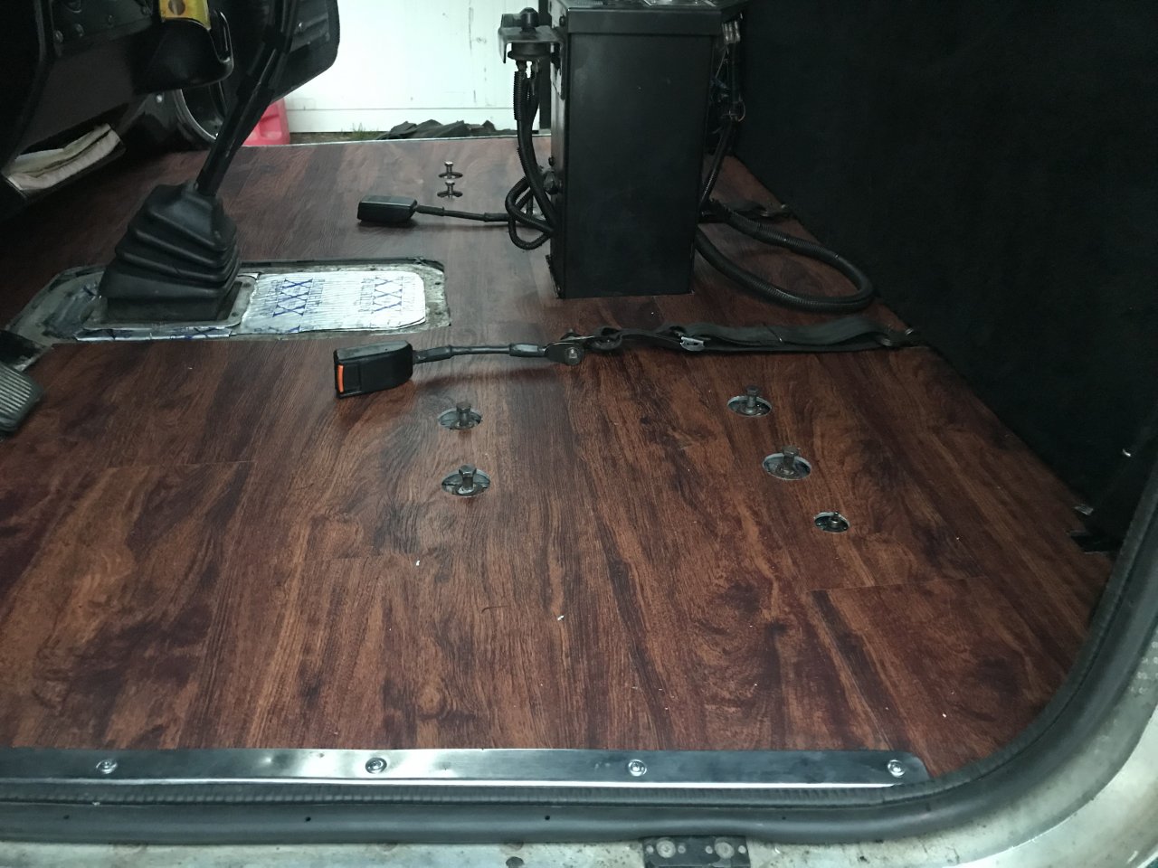

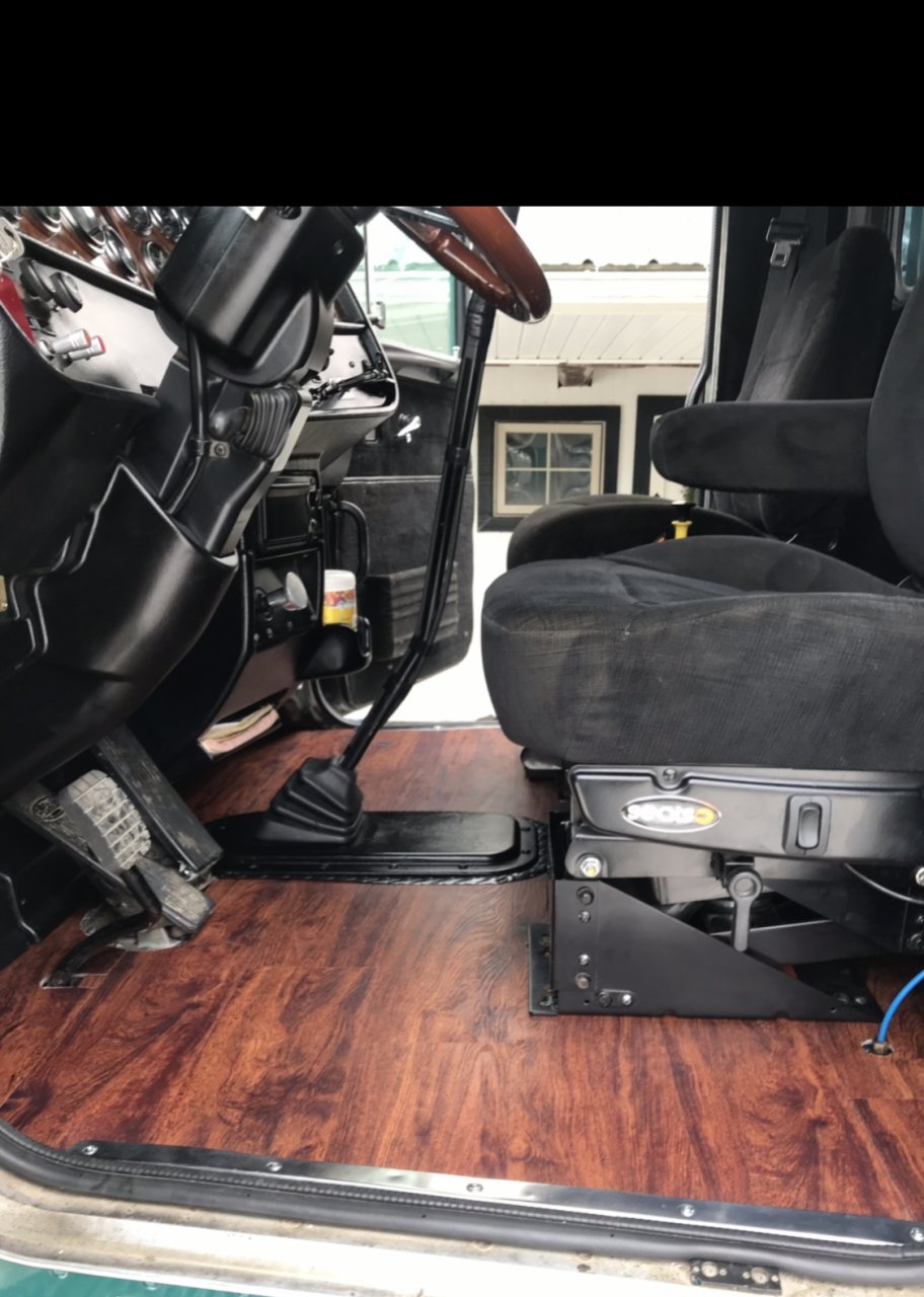

    Could a guy just put that over the carpet floor, or would it be to high?? Looks great by the way.

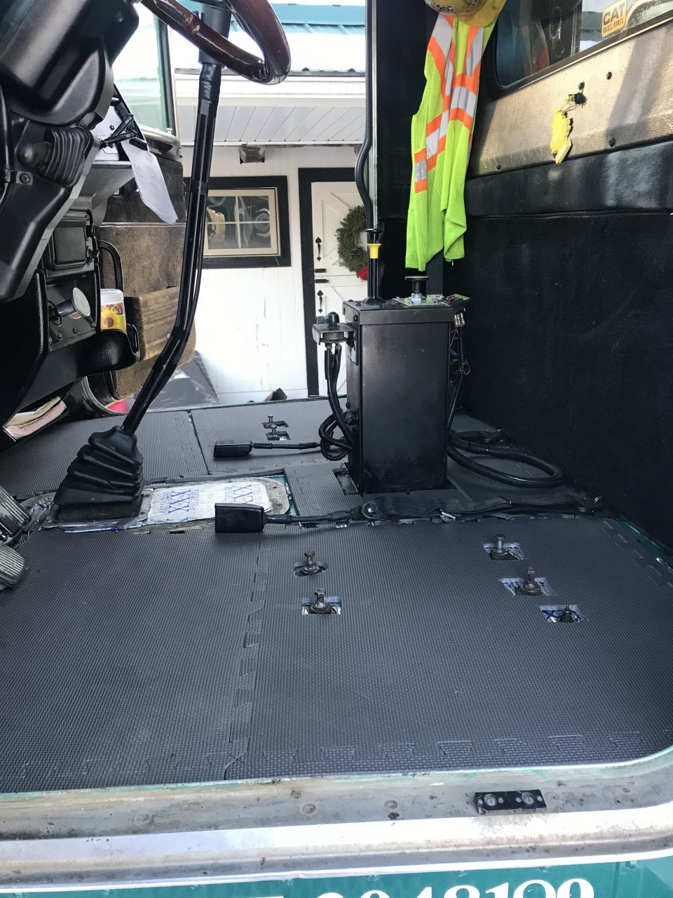

    You absolutely could. I used 2 layers of the red foam sold at Home Depot and the wood I used was thick. I will have to double check but it was like 3/8-5/16 I was surprised. I still had maybe 3/8 space left under the drawers on driver side and under the fridge on passenger side.
    I have tons of that foam flooring stuff but never thought to use it. That would maybe make the floor too high to go under the fridge and drawers.

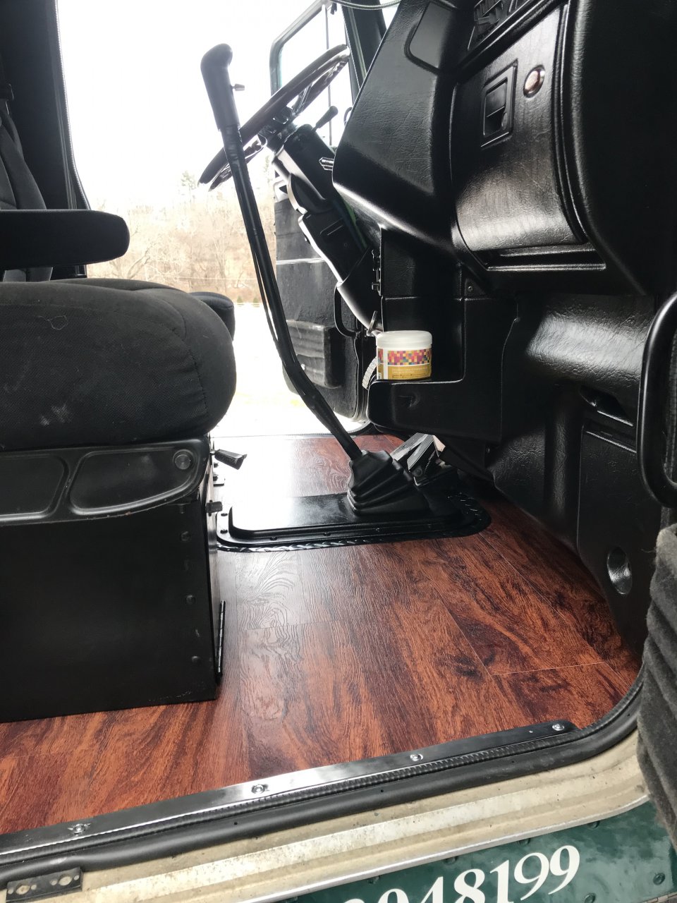

    Wow 1 box did that for 40 bucks... Screw you Raneys!!!!!
    They want $999 for a KW. Comes in a kit, go look it up.. bunch of thieven crooks!
    Good thing I seen this post. Thank you... I'm gonna do this in my KW..

    Why can't you do it on plywood,it's just like having a sub floor.You could even change the plywood,use some marine grade.

    Probably be too tall. The door sill trim probably wouldn't fit on it properly.

    Yeah I saw the 999 bucks on raneys. I actually had one plank left over. 38 bucks. I do have a day cab though

    I got a sleeper but biggest part that needs planks is where the seats are. Sleeper itself is mostly bed... did you buy the laminate kind that snaps together?
