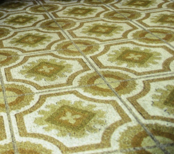

    Well, vinyl, but just as cheap lol. I kept cutoffs from my kitchen 10 years ago and finally found a use... I did go fancy, and used adhesive backed closed cell polyethylene foam and put a layer of some leftover Dynamat down first.

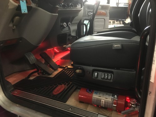

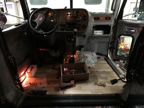

    The planks stick to each other. You do not anchor them to the subfloor. The floor stays in place from all the cut outs. Nothing to pop loose. The sticky planks are flexible and will not break through time like the hard planks you snap together.
    Not a dumb question. My truck is a construction truck. Triaxle dump truck. I’m in mud and dirt all the time and quarry’s. I chose these planks for a number of reasons. One reason is becuase my floors in my house have not one scratch on them with 2 crazy border collies running around with long nails. I think these floors will hold up fine. I did make a custome piece of 9”x 4” brushes stainless for a heel pad so my drive foot heels don’t wear a hole in the floor

    I like this better than my floor. That’s a one piece? You used old floor as a template?? Man that must have made life easy

    Yep, it's one piece, wih the foam backing attached just like the OE rubber floor. I kept looking at the floors on Raney's and figured for the chance to hold onto $1,000 it was worth taking a shot. I actually was going to do something like what you did, but none of the flooring places had anything I liked in stock and I'm impatient.
