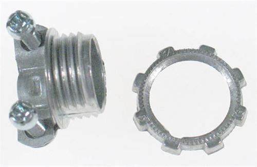

I've found the absolute BEST way to do this is to use a Halex cable clamp.. this takes a little more effort but I have lost no sleep worrying about the possibility of my truck burning down because of a short..If you take your time and either punch or drill your hole carefully.. this will thread into the hole and then you cinch down on the cable with the screws... done..
