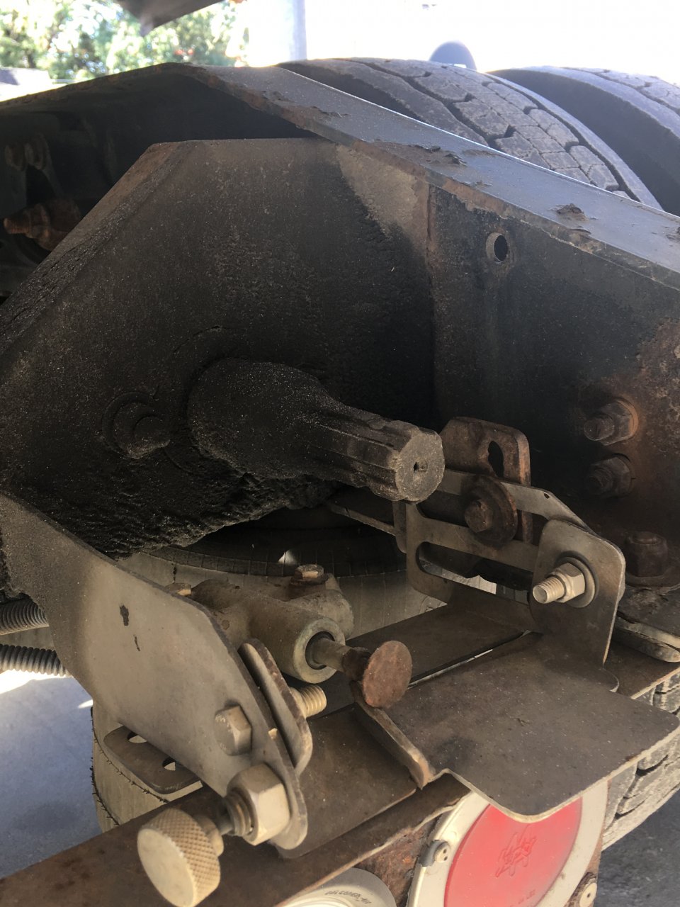

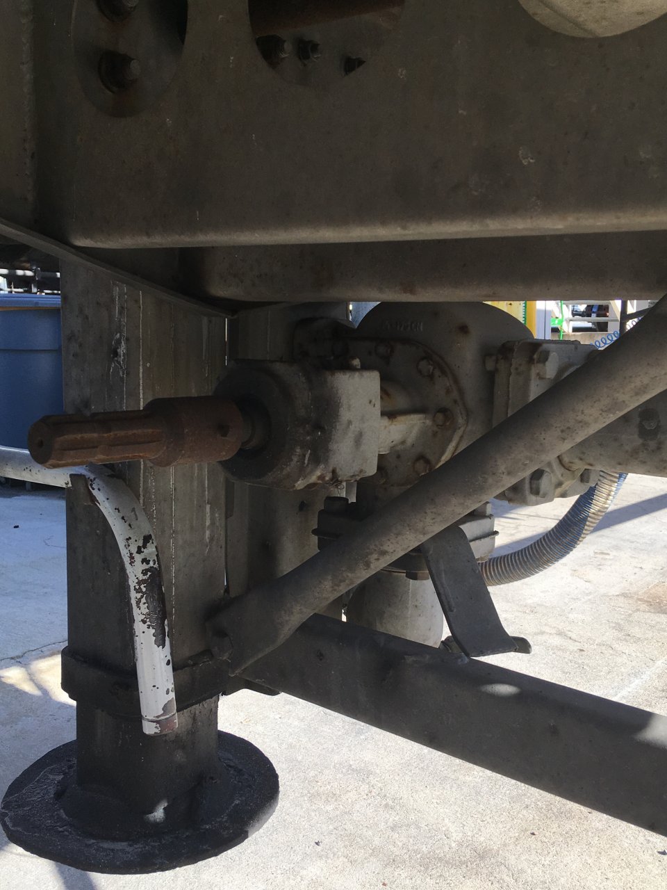

    Our pumps are mounted on the trailer between the landing gear. And a PTO shaft connection at the rear of the tractor frame. Works great. You just have to park straight and don’t forget to remove the shaft before you leave.

    A lot of propane tanks are set up that way. The pump is connected to the internal and you connect a shaft to turn the pump. I've seen them either hydraulic and pto driven. I've also seen hydraulic shaft. (The shaft is mounted on the rear cross member of the truck, but uses hydraulics to turn it) Our propane tanks are straight hydraulic.

    Why? It’s simple and you need less hoses. Plus, you can drop off the trailer at the tank wash and you don’t need to be around to wash out the pump.
