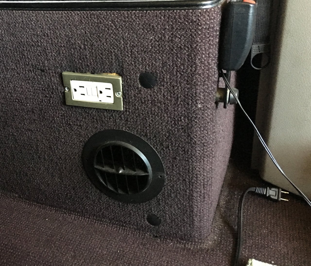

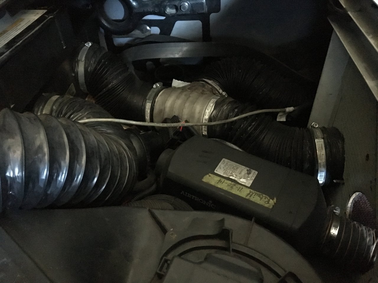

    I'm curious, did you install all the interior bits in between the bench seats or did you find a way to put it under the bunk passenger side bunk and integrate it into the existing vents?

    Yes I installed the evaporator and the espar heater under the bunk passenger side. There are several way you can consolidate to save space. I installed them in two deferent ways. When you make your marks for the pass through watch and make sure you’ve clear floor supports, I accidentally cut through one of mine. About the vents, yes I cut a 4in hole on the passenger side of the bunk and installed one duct from the evaporator, and the other duct from the evaporator I tied up with a splitter into the truck sleeper duct.

    Can you possibly post a picture? Just asking because the truck I just bought has it installed between the benches and its awful.

    Actually I went to pick it up and it turns out it was installed correctly under the passenger side bunk. Though they ran the duct work separate from factory auxiliary bunk cooler. Tied 1 into the vents though.

    9A4A0DBE-829D-4272-A145-B34693547343.jpeg 76D4B470-DD94-4640-83D7-A12F441B7899.jpeg 55CA6387-9078-4824-A171-EB8A7DB173B3.jpeg AE9B9737-0A5B-45D6-9967-D48C8EB0425A.jpeg
    I was waiting to catch-up with the other truck so I can send you pics of both setup, but yours is set up just like my other truck except I used a splitter to be able to install two vents under the bunk, one on each side of the bunk under the table. And secondly I removed the panel where the installed your sleeper vent and tied into the factory ducting so I’m able to get air at the top bunk. Other than that the evaporator and the other stuff are all like yours. The pics below are the first one I installed on this truck and the placement of the evaporator, heater etc are different.
