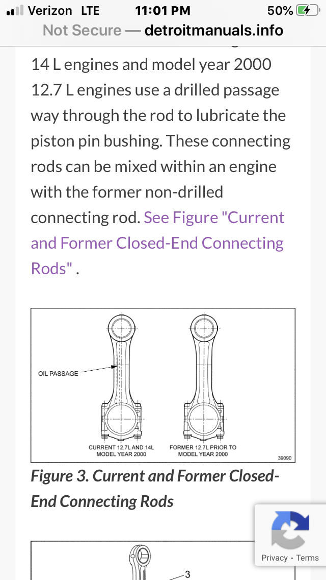

    Same as mine. Except mines a BK. If you don’t have nozzles, already, your blocks drilled and plugged. My rebuild kit came with new nozzles. I found the info on the rods. They use the same crank, and can actually both be used in the same engine, according to the manual. I don’t know why anyone would do it. It doesn’t mention it, but from the OPs post, the nozzles would have to be removed and plugged, to use a drilled rod. The oversized bearings/ undersized crank I was thinking of was an upgrade on Natural Gas engines only. The only other thing that may be different between our engines is the cam. If you need injectors and a cam anyways to make it a 500, along with a ecm settings, might as well get the best combination. Lots of info on here, about that. I’m happy with mine, but apparently there’s better options than my cam and injectors.
