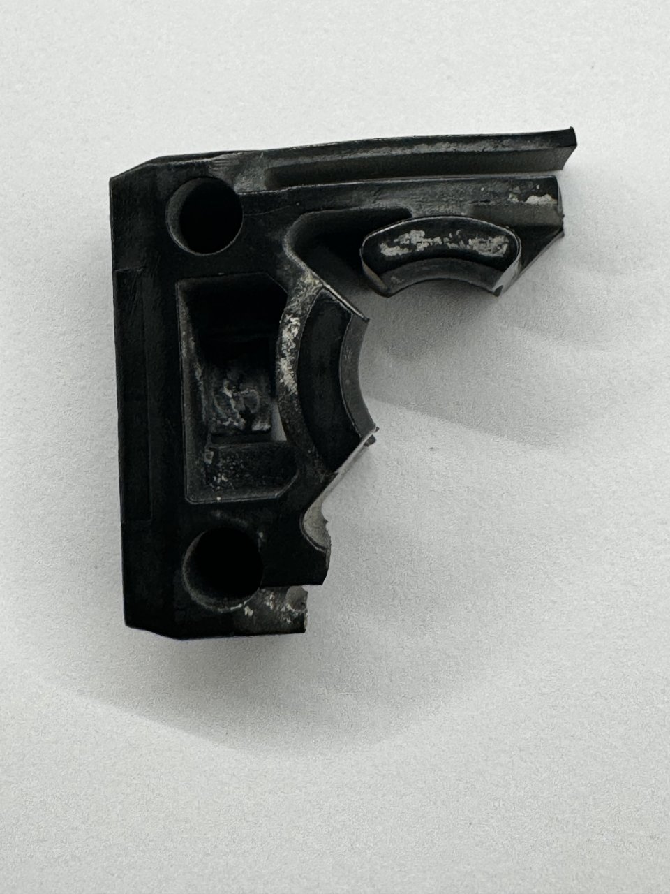

    I have been scouring the internet trying to locate the plastic window glide that clips onto the window arm and slides in the channel on the door glass. My chassis is an International 4200.

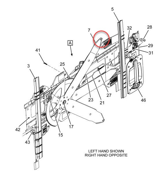

    Here are some photos of the regulator and where the glide attaches and a picture of the broken glide.
    Any help is appreciated!

    3 options that i know of if the dealer cant help you.
    1. Call vander haggs or another junkyard and ask if they have any 4200s and can sell you that specific part.
    2. Buy a whole used door from them for $165 International 8600 Door for Sale .....i have no idea why every time i paste the link the webpage changes it to an 8600 door. You will just need to do a search yourself i guess.
    3. Buy the entire above door or take the door on the other side, open it up to get that part. Then find a 3d printer company and have them make you copys of that part. Reinstall old part into whatever door it came from and either sell the extra door, keep it for spare parts or reassemble your other door.
    You can find people who own good 3d printers online all over the place and ive had them make me 1 off plastic parts before. They dont quite match cosmeticly or materially usually but they have worked as long or longer then the factory parts and do the same job. Ive found the 3D printed stuff is usually way more durable then the factory stuff most of the time anyway

    Hey there
    In case you still would like to know the part number for the
    Replacement clip.. ive been in the same boat as you and I finally found the right one.
    Part # BWR5367
    For Mercedes Axor (Euro model)
    Ive ordered it from Amazon $12 CAD for 2pcs but it is exactly
    The same size look etc.. the only thing I noticed is the center hole doesn't seem to have the pressure fitting tabs but I have not installed them yet. That difference should not be a big issue..
