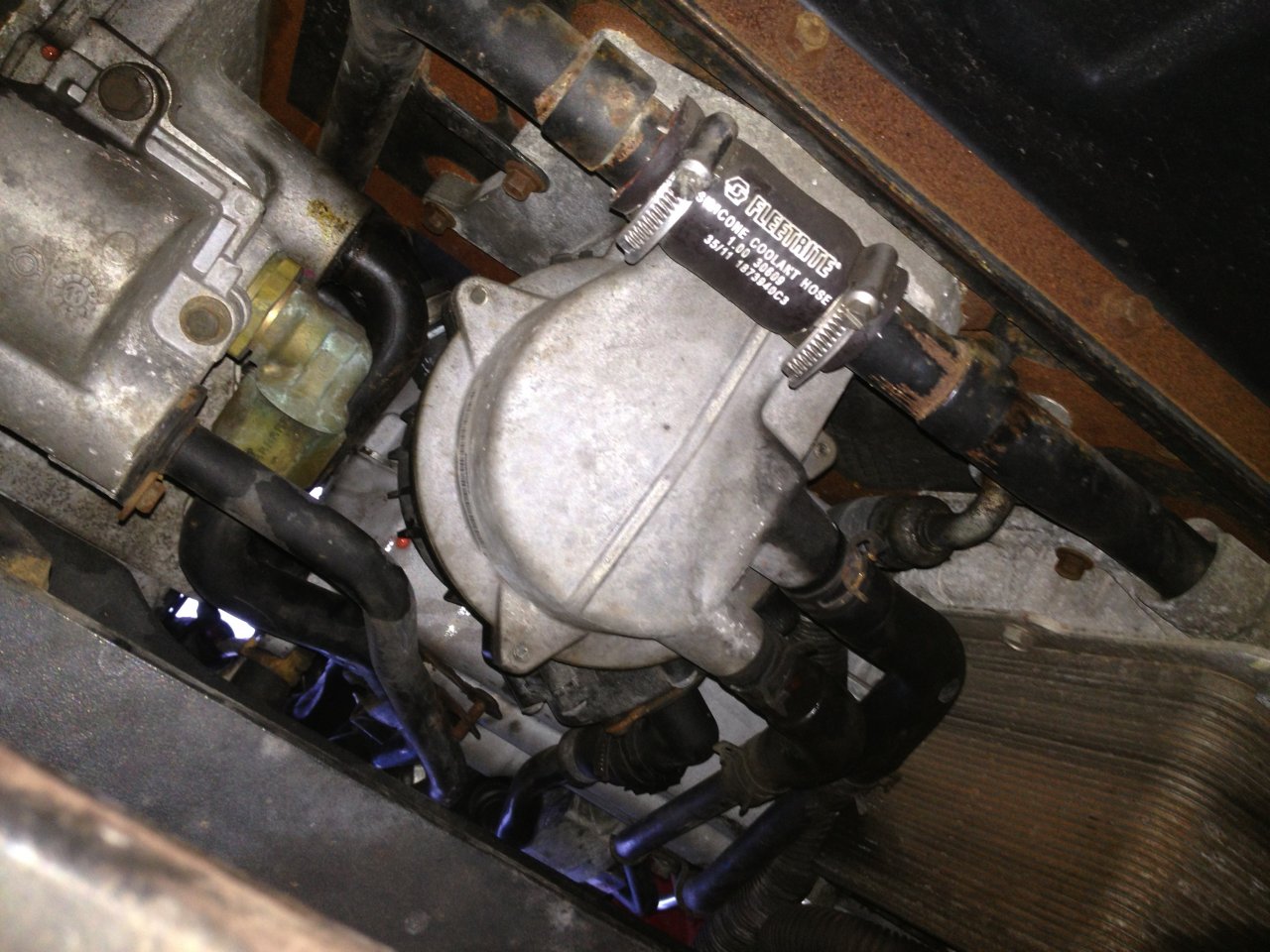

    THIS IS A MAXXFORCE 10 underside of motor. Why all these coolant leaks and where are they coming from? it was 30 degrees out.
    I have always had the leak in egr cooler to overflow fitting since the egr cooler replacement.
    first two pictures are behind radiator driver side.
    next 4 pictures are underneath passenger side near front axle.
    IMG_8482.JPG IMG_8481.JPG IMG_8485.JPG IMG_8491.JPG IMG_8478.JPG IMG_8488.JPG IMG_8484.JPG

    In the top pictures is actually a thermostat in that housing. The housing can leak between the two sections. As for the rest, unless your engine is six months or newer every single hose that is removed to do a repair MUST be replaced!!! These engines are just too hot and the hoses harden up and will not reseal! It also looks like the vent hose from the egr cooler is over tightened and has split the hose. I never reuse the International style hose clamps either with the ribs. If you over tighten them they will cut the hose every time.

    Rad cap popping off at 9 psi is a bad cap. These engines do over cool because of the egr system, many of our customers install winter fronts to keeps the temps up.

    Today they mentioned it could be the surge tank. Either cap not seating right or the neck of tank could be oblong. They said cap should never pop off but only allow overflow from surge tank?

    6,200
