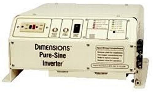

    First of all it's a square wave inverter.
    Your AC unit isn't designed to run on a square wave. The compressor motor is probably getting really hot. I have a pure sine inverter That's rated at half the capacity of yours but it's four times the size, weighs 40 pounds, and is 5 times the cost. Something like that would probably be much more suitable for running an AC unit without shortening the life of the compressor.
    If you're looking for 3000w inverter, this would be your best bang for the buck and it's made in USA and it won't shorten the life of your compressor.
    https://www.amazon.com/SENSATA-DIMENSIONS-3000N-FREQUENCY-INVERTER/dp/B00FG5MARU
    Trucker327 and FlaSwampRat Thank this.
