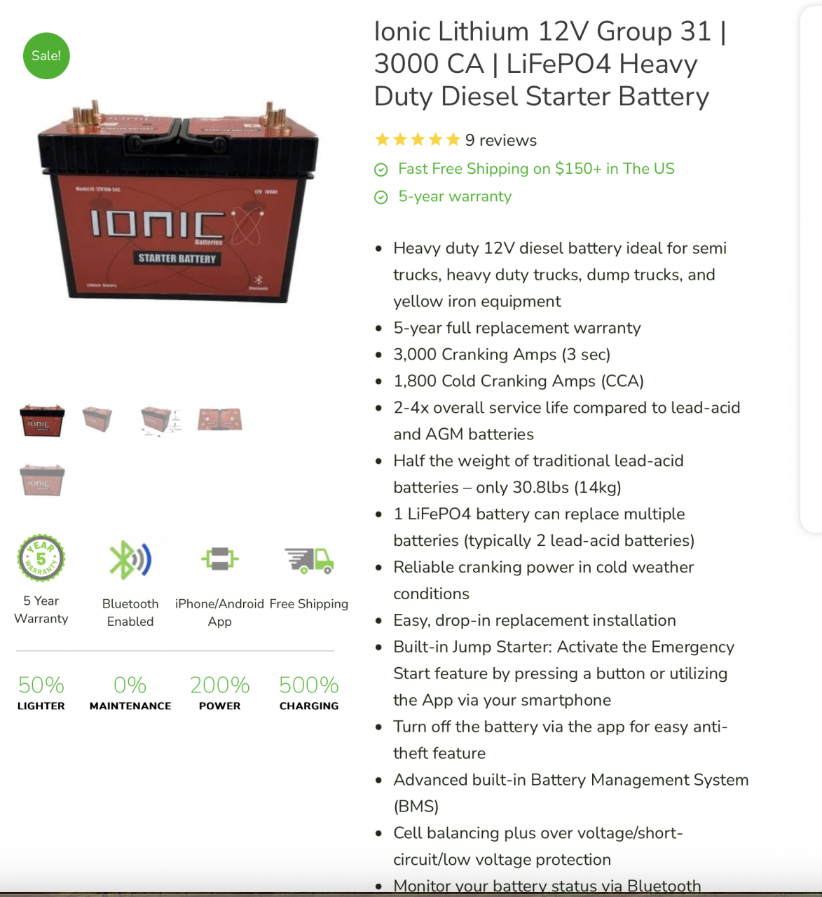

    Do not mix batteries.
    1 - the BMS of the LiFePo will cut off the battery if the voltage exceeds 14.4/.5 volts. most truck electrical systems will see ~14.7v. The other part of this is the charging profile is different between batteries, so with a LiFePo battery, you may want to use an external regulator like a BalMar.
    2 - there is a problem with balancing in an idle state. The agm will pull power from the LiFePo battery and draw that down.
    3 - there is also a problem the AGM or LA battery going bad and having a shorted cell, which produces heat and if it is hooked up to a LiFePo battery or batteries, then that battery with that bad cell is going to pull a lot of current from the LiFePo and that could be a fire hazard or at least cause the battery to boil.
    My question is why does anyone want to go to a LiFePo battery in the first place?
    Trying to spread the cost of the battery over time or just want to impress people you can say you have them?
    My trucks don't use them unless they came this way from the factory and we definitely do not use them for a starting application. We did a lot of testing and the best combo so far has been the maxwell starting module with AGM or LA batteries for the house. The LiFePo batteries that we have all are internal to the sleeper because of the low temp cutoff which can be triggered as high as 15ºF if it is outside.

    This is the battery I got and talking about https://lithiumhub.com/product/lithium-12v-3000ca-lifepo4-semi-truck-starter-battery/
    This has proprietary set up in the charging and BMS
    These have bluetooth app as well to see what it is doing at all times. I have the TriPac Envidia EPU and will look into how it is truly installed. See if I need to change how they are charged with these new batteries. Most likely will need to add a controller in front of them to charge them correctly without draining the Lithium batteries.
