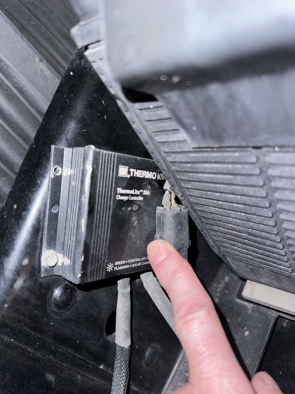

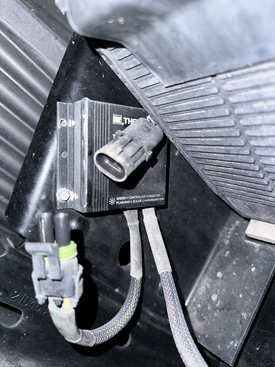

    Sorry miss understood yeah.
    It is a ThermoLite 110W and has the charge controller with it. I may need to change it out since it is designed for AGM and flooded batteries.
    May not be a big enough issue since it is less than 400W based off of some stuff I read.

    Maybe something like this would work.
    https://www.amazon.com/HUINE-Waterp...ge+controller+water+proo,aps,241&sr=8-11&th=1
    Would have to cut the wires instead of plug already made up. Dont think they make the same brand. Not sure will have to try and figure that part out.

    Sorry I didn't see this sooner. If you didn't already order spend just a bit more and get an MPPT solar controller instead of PWM. They are much more efficient.
    I would be willing to bet the Thermo King one is better quality than the Amazon type, either one you posted, but I don't know that you could easily find out the specs on it.
    I have LiTime batteries from Amazon in my camper (300ah lithium) and their quality seems to be pretty good but I'd still go MPPT.
    Victron is top shelf stuff. Their basic MPPT controller is only $65. I'd go this route in a heartbeat:
    https://a.co/d/eL5lylp

    I second 86Scotty's post, get the Victron, get the app. It is the better controller. The TK unit is a PWM.

    I went with the second one. I just finished installing the batteries and the solar replacement part.
    think the solar piece added has an app. I need to look into it and see. I know the batteries do so can see what all is going on. With them.
    I don’t go back out except to deliver tomorrow until Tuesday. So will see at that time if two are good enough. I have a feeling I should had went with three.
    Truck cranks great and everything seems to be working right. Looking forward in seeing how they perform.
