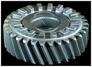

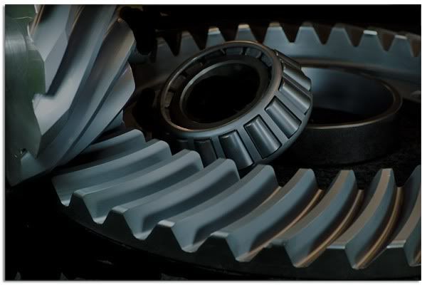

    It has already shown a difference and you can actually feel the difference when you first drive with them with alot freer rolling truck.
    Can't wait to have the rear ends done.
    You guys in Europe might want to check with some for F1 teams over there because I know this technology has been in racing for at least 15 years and has even progressed and developed even further. All the bearing manufacturers know of or even have this technology in house.
    I know Timken sends simular tecnology to NASCAR teams in a hub bearing package. They are real secretive about the process too.

    Both Rear End parts micro-polished and coated at MicroBlue yesterday. Should be installed in my truck next weekend with road testing in August.
