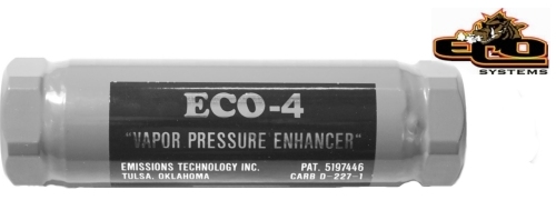

    There is a fuel device in this thread:
    http://www.thetruckersreport.com/truckingindustryforum/ask-an-owner-operator/122596-ecotaz-eco-fuelsystems-fuel-enhancers-does-10.html
    It has a cost around $500 and is posting fuel saving from 5%/0.031 CPM to 8.6%/0.056 CPM. If you figure a mid-range savings of 0.043 CPM, it will pay for it's self in 11628 miles or less than 5 weeks. It will then save $430 per month or $5,160 per year.

    What is that ecotaz system? How does it work?

    He explains it in that thread. He has given about a half a dozen drivers, on this forum, one free with the understanding that they report the results on this forum. He is quite confident in the product. Preliminary results look very promising with respect to cost. There is a good mix of trucks, engines, lanes and gross weights.

    Sorry to hurt your feelings on this one, but that is no different than the Turbo3000d Vada that has ripped off a many a driver.
    Looks like the samething.....
    There is no proven science to how it works and no proof it does work like the Turbo3000d Vada. There is no way running fuel through a baffled tube of metal will increase fuel mileage.
    I tested the Turbo3000d Vada years ago with no change in fuel mileage and sold it to another driver that believed it worked.
