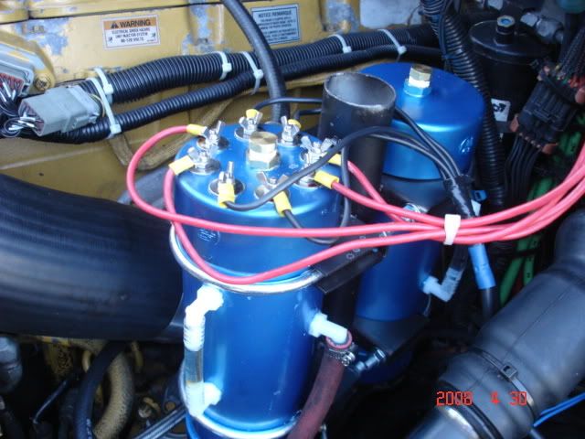

Its called HHO. On Board Hydrogen Generators can create Hydrogen and be burned with the truck. They run off the alternators or an onboard generator (The Higher the output of electricity, the more amount of Hydrogen produced. Hydrogen can burn like diesel, it burns more efficient as well. No mods to the engine, just the generator hooked up + and -, then the tube carrying the produced hydrogen to your air intake. I know a guy who has a small one on his truck. He is getting a Large MPG increase with his 2004 Volvo D12.
Here is him on Youtube: [ame]http://www.youtube.com/watch?v=7fWd1H1C3Oc&feature=channel_video_title[/ame] -
Been there done that over 3 years ago. Took it off for a full refund after using only 3 weeks.
![[IMG]](proxy.php?image=http%3A%2F%2Fi29.photobucket.com%2Falbums%2Fc264%2FDice193%2FGenerator%2FHydrogenGenerator003.jpg&hash=b4b7a1ebc9522eaefad66d0cd5528aaa)
Technology not ready yet or even proven it can work!
If you buy one, make sure it is made of stainless steel with a large capacity tank with automatic fail safe devices for too high temperture and low electrolyte or you will have major problems. Takes alot of energy to make for what you get back out of it.
Pittsburgh Power was even working on a unit and abandoned the project because it would not work efficiently. -

"Been there done that over 3 years ago. Took it off for a full refund after using only 3 weeks."
I know that HHO systems work only on video or paper. It is nothing but pure BS. Did you buy that system from a guy out MN somewhere? -
