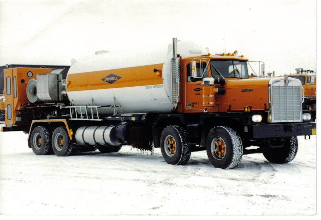

    One of the best oilfield jobs I ever had.
