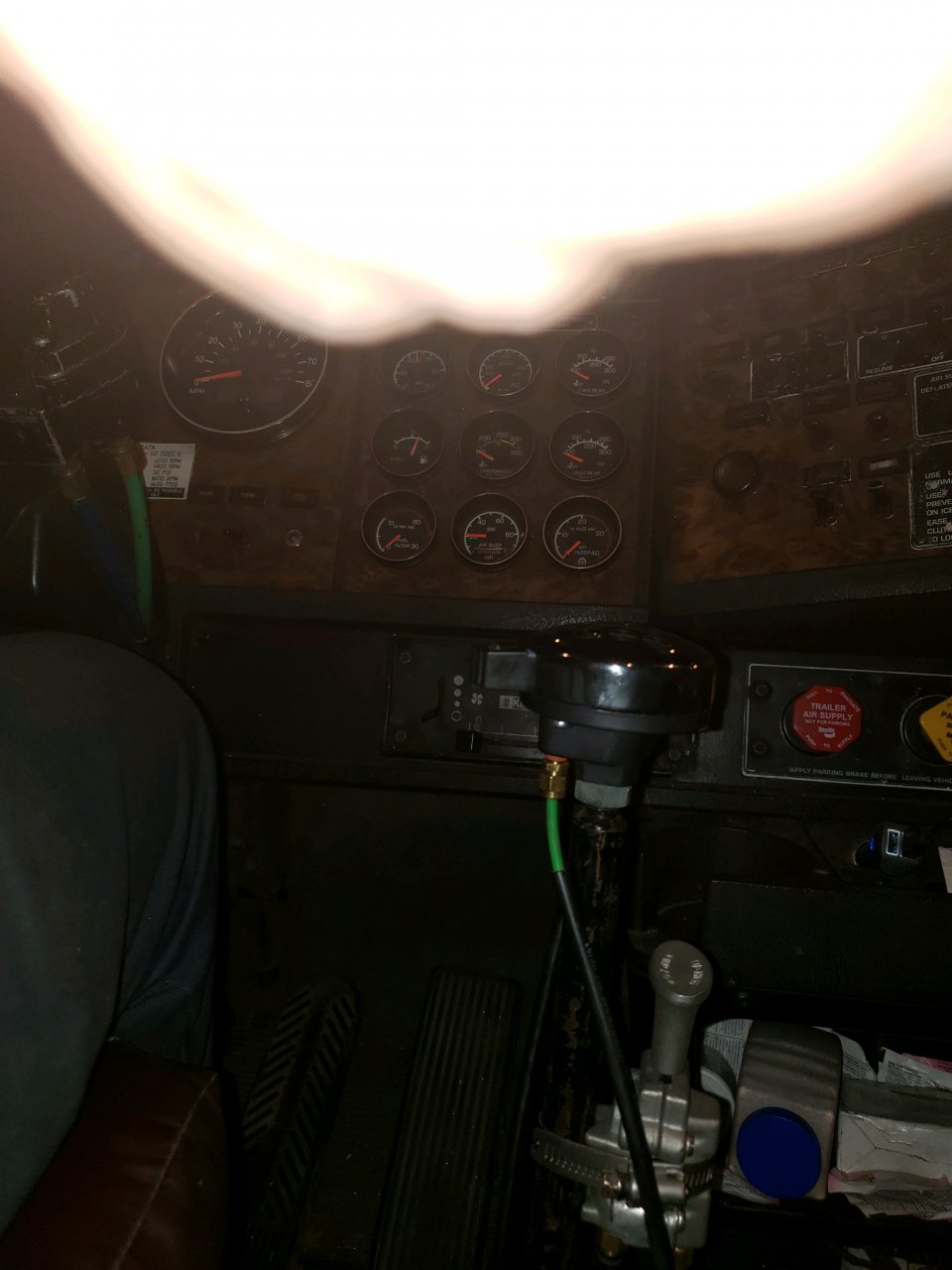

    RTO125. 8th back at the passenger seat. It’s a 52 year old knob with 3.6 million miles on it so the numbers are worn a little bit. Lol.

    I've got one of those on an old tranny in the barn. Never thought about sticking the knob on a modern truck. I might have to do that id I can clean it up good.

    They work but you may have to swap the dir and splitter lines on the new trannys. Friend of mine put a RTO146-13 that uses the new “ergonomic” style knobs in a ‘75 White-Western Star that had this same style chrome knob and it wouldn't work. If I remember right it was in dir all the time and when you split to od it would go to low. We finally figured it out about crossing the lines and it was good to go.

    I like the looks of these, but I like it 1 position on the knob and with a plunger like this 66540.jpeg
