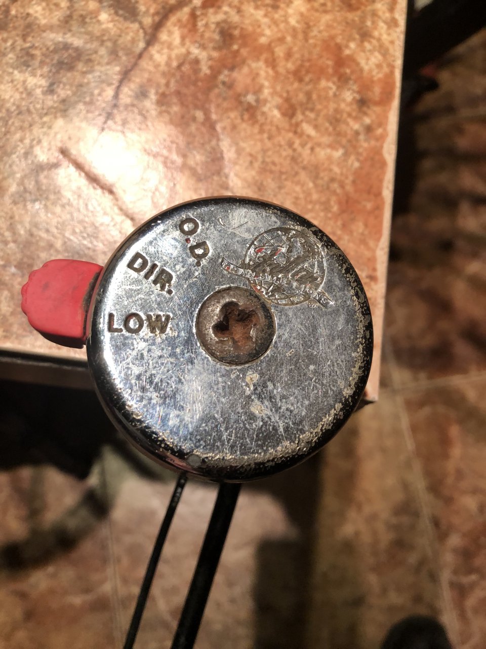

    These were the first generation 3 oosition 13 soeed knobs.
    its the same lo position as the 13
  6. SmallPackage
    5,644
    18,043
    Dec 20, 2019
    Marion Texas
    4BC0C9FF-6CCC-4393-81FF-B0405072D0C9.jpeg This is the first generation 3 position 13 speed knob. Notice the worn down old Eaton-Fuller-Towne and Clark globe logo on it. I found this in a box of old parts at a friends truck shop years ago. Don’t know what brand cab it originally came out of. These were cool because you can take out the center screw and put on an old school glitter ball from a twin stick on the top of it. I’d love to use it but you cant get the seal kit for it anymore and it has a plastic “puzzle” piece that fits inside that is cracked. So i just keep in a display case in the living room.
    Bean Jr. and x1Heavy Thank this.
