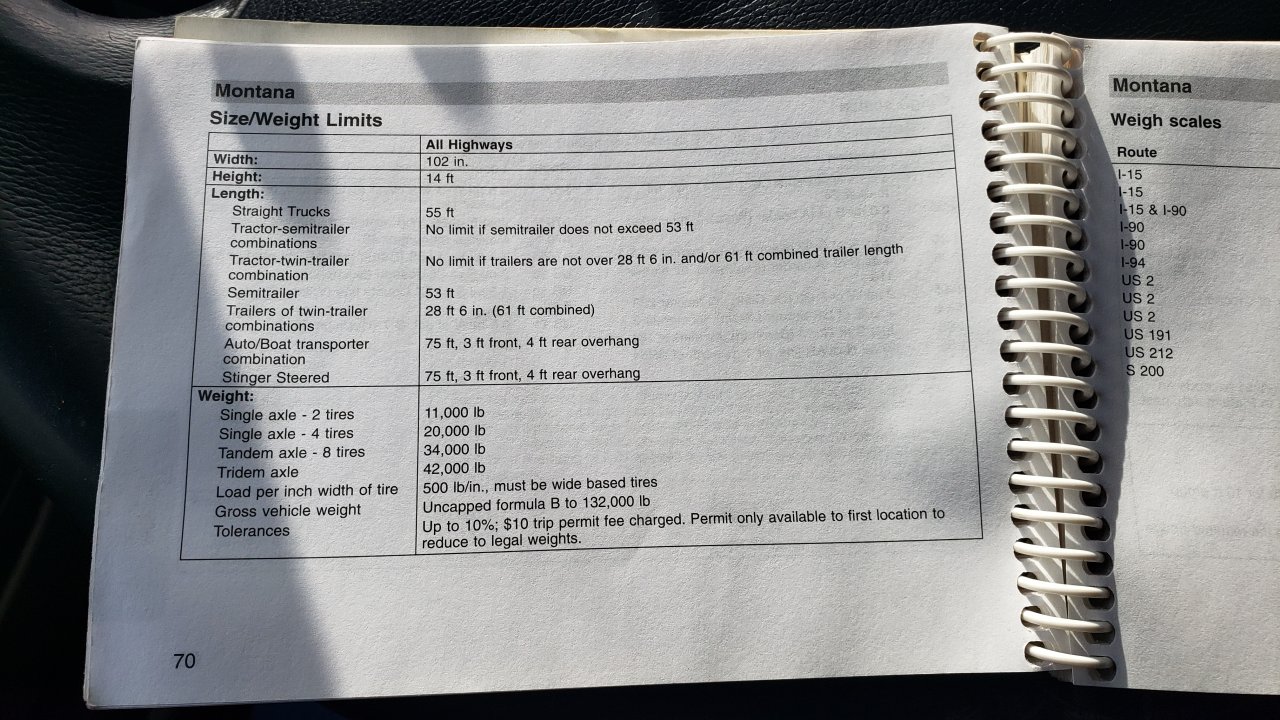

    *****Disclaimer******
    I am not an attorney nor do I pretend to be one. The pictures below were current as of 2009

    No limits specified, according to this anyway.
    Kingpin to Rear Axle Maximums – Big Truck Guide

    In some states yes and others no. I think my state called the violation an "overlength violation." Lots of newbies only know 2 positions for the tandems, fully forward and fully back until they get a ticket.

    overall length, no problem
    king pin to trailer tandems, real axle or center of axles, ect. east coast has limits.

    In those 3 states you’ll be fine. ID is the only one that has limits if you’re off the National network routes.

    I know Tennessee has a kingpin to rear bumper or rear axle limit
    I think a 53 van is ok but a 53 triple axle RGN that doesn’t have the adjustable kingpin is about 8 inches over the limit , and they WILL cite you for it if they are paying attention when you roll through the scale .
