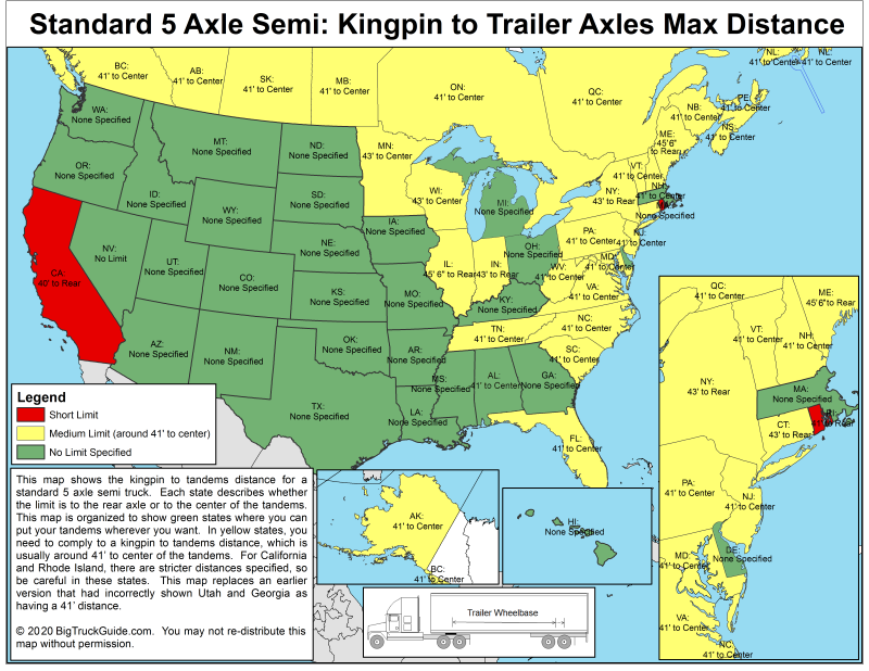

    Here in NY, we have a 42" kingpin rule, which was pretty much all the way back for a 48" trailer, and an even 5' rear overhang on a 53' trailer. Pennsylvania has a 41" rule, which is usually 2 holes past the California hole (40'), which is usually marked with yellow on NEW trailers. Most trailers have the furthest forward hole as the 39'6" off-interstate hole for Idaho, then each hole is a further 6", so they work out as follows"
    #1 hole: the "Ida-hole"
    #2 hole: CA
    #4 hole: 41' (PA, others)
    #6 hole: 42" (NY, others)
    etc......

    I use this for reference
    Bud A. and Numb Thank this.
