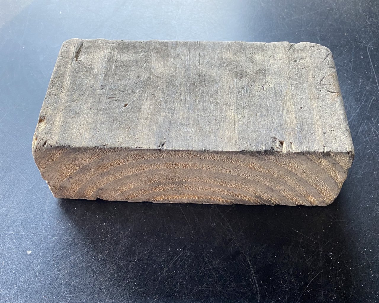

    Load locks can be placed vertically. If your load locks don’t reach the ceiling, place a small piece of wood under it (see image). Newer trailers are higher than older ones. They do sell taller load locks, but they can be hard to find.
