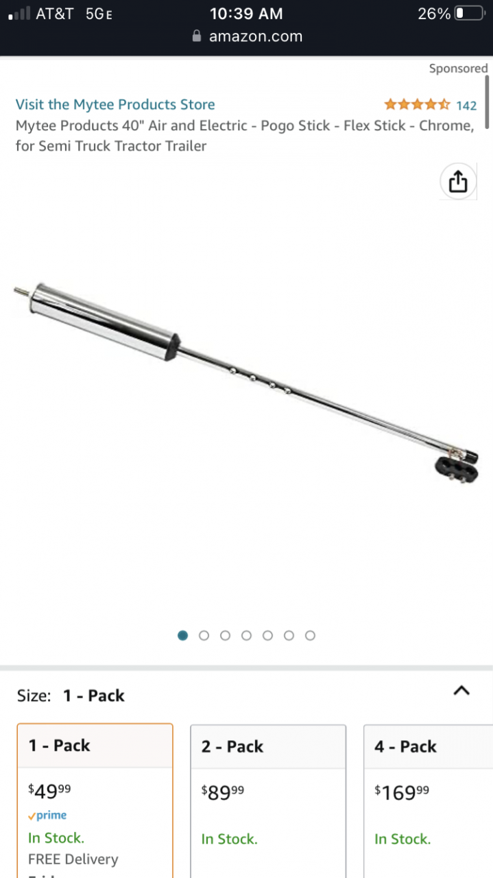

    After you spend 100s of thousands on a truck you get a wonky cheap pogo stick leaning with a about to be blown spring, but no your asking for trouble on the deck.

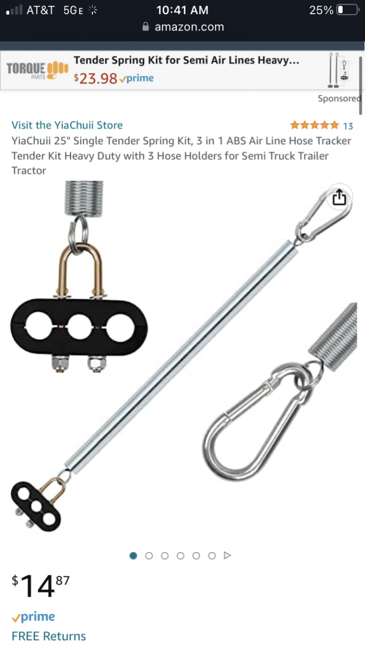

    It is ok to have pigtail touching the catwalk. Keep an eye on it so the hard wrap doesn't wear thru.
    I would get a couple of the spring retainers that mount on the bar on your cab.

    Even cheaper, click it right on to the top handle EC86C10C-DFA4-4BA9-9497-73ECACE0B476.png
    77fib77, Concorde, LoneRanger and 8 others Thank this.

    Get a new pogo stick and put a loop in your lines to take up the slack.

    I was told during a DOT inspection, it’s not allowed to touch. You’ll have constant chaffing, so it makes sense.
    Hang it from your upper rail. That’s what it’s there for. Get the 2nd kit “abyliks” posted. It’s what’s on my truck and works perfect, from the upper rail.
    You’ve spent the money on a nice line set, take care of it.
