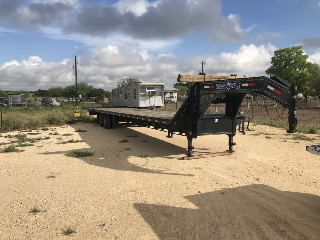

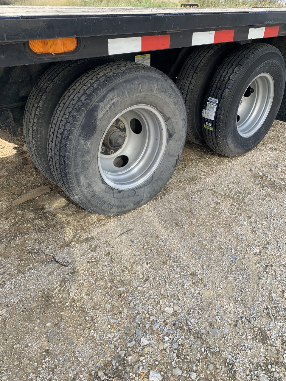

    My bad I meant 25GN the one with 12k axles 35+5 with the dovetail so a 40fter.. I picked it up today, but driving home I could tell it was dog walking. Pulled a tape measure on the wheels and the right side is about a 1/2" difference from the left side so it's walking toward the curb. There are adjusters on the axles and Big Tex apparently didn't do very good quality control before sending it out the door. Have an apt to get it fixed for Mon but a bit annoying because was hoping to go get the trailer inspected tomorrow and head out with it Monday. I may just adjust it myself so I can get it inspected this weekend and still head out. Shouldn't be that big of an issue TBH just I shouldn't have to do that to a brand new trailer so a little peeved on that. (the rest of the trailer is fine though, overall pretty happy with it)

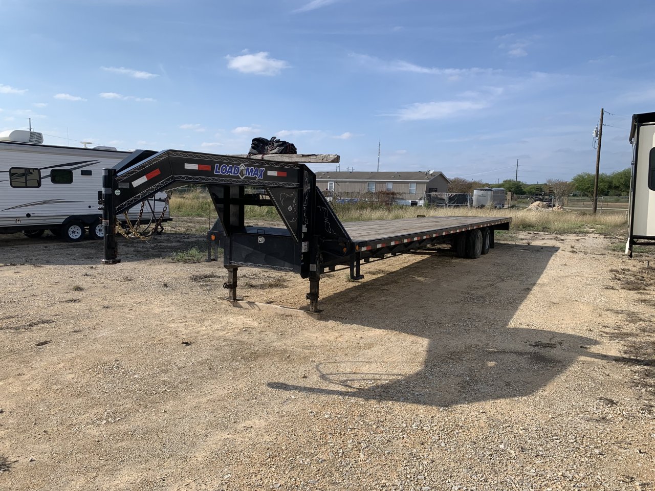

    As far as mods. I'm planning to have the gooseneck chopped off and have a 12ft step deck built on it with a 5th wheel kingpin. I'm gonna run it a bit 1st before I do it but that's in the plans hopefully before springtime.
    The current gooseneck length from the center of ball to the back of the upright i-beams is roughly 8.5 ft. If I go 12ft I'm extending the length of the gooseneck by 3.5 feet but the kingpin will be set back around 1ft to 1.5ft So I'll add a total of roughly 2ft to the total trailer but I'll gain 12ft of flat deck space at roughly 45-50" to the top of that deck. Meaning my 40ft trailer will then have 52ft of overall usable deck space but will only be 2 ft longer.
    (I'm looking to build a step-deck like this https://www.appalachiantrailers.com...2020/07/step-deck-car-trailer-appalachian.jpg ) but it will be better usable for freight than that one is.
    I'll end up putting extenders up at the front of the step deck so I can get cars on there no problem and don't accidentally drive off the front. (extenders like you often see on 3 car wedges)
    The 2 boards on the outside of the main I-beam frame I'll be removing to put punched steel decking so I can easily tie down cars with over the wheel straps and it will be level with the deck boards. (punched steel is like you see on big semi car trailers the sections the wheels go on with all the holes so they can tie down to them.
    Last is the dovetail.. I need to run the trailer a bit to sort out what I want to do there. Currently, it has the upside-down angle iron on the dovetail which is too rough to run a small car over. I'm toying with removing the angle iron, added some supports in, and then putting the heavy-duty wire mesh there instead like they use on car trailers.
    I'm not really sold on the MEGA ramps.. I need the dovetail for cars so I went with the mega ramp model but I might pull the ramps off completely. I tested a bit ago.. I was able to load a crew cab F350 short bed and a F350 extended cab long wheelbase on the trailer but I couldn't get the ramps all the way up. (partly due to one truck had a long hitch.) If I make a longer securement bar that I can switch out when I have 2 trucks I can run it like it is now no problems but I have a different idea in mind and I might remove the mega ramps and change up the dovetail a bit so I can still load cars and have the full 40ft but I have to play around with that idea 1st and it's hard to explain.
    Anyway, if I can do all these mods I can probably have 4 small cars or 3 normal sizes or 2 trucks/vans and 1 small car. However, I can still fit a 40 ft container on it, haul equipment and have 52ft of flat deck space.
    Will be a very versatile trailer once done. I was looking to have someone build it for me the way I wanted, but I needed a better trailer now and after thinking it through, it made more sense to buy a 40ft deck and modify it because I can use the trailer right away and then do the mods as I get to them.
    I've been thinking about what I wanted a long time. I have a local shop that builds some quality stuff that I'll get to do the gooseneck. In all honestly, I think they can probably do it in a day 2 at most. It's really not too complicated but I need a shop to do it so they can recertify it so I don't end up with DOT issues. The dovetail mods and other stuff I'll be doing myself.
