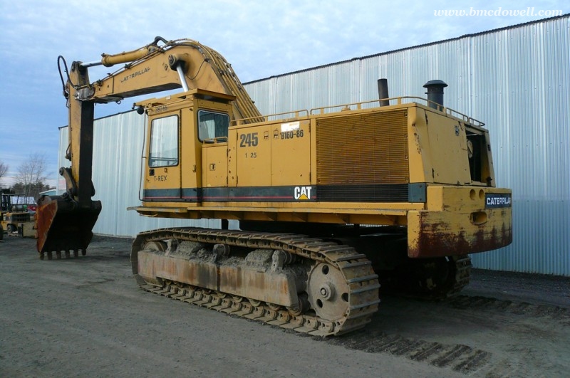

    We used ether to start heavy equipment that used glow plugs like a D9H or 245 excavator... caterpillar-excavator-245-b160-86.2_f.jpg They were "ether babies" that would no longer start without ether. Maybe the rings were shot from not enough lubrication over the long term of starting with ether. Ether will help get it started when the battery isn't good enough to run the glow plugs long enough in the winter, a quick fix to get it running, it's a double edge sword...

    The 245 and 9H were 3406 engines. No glow plugs
