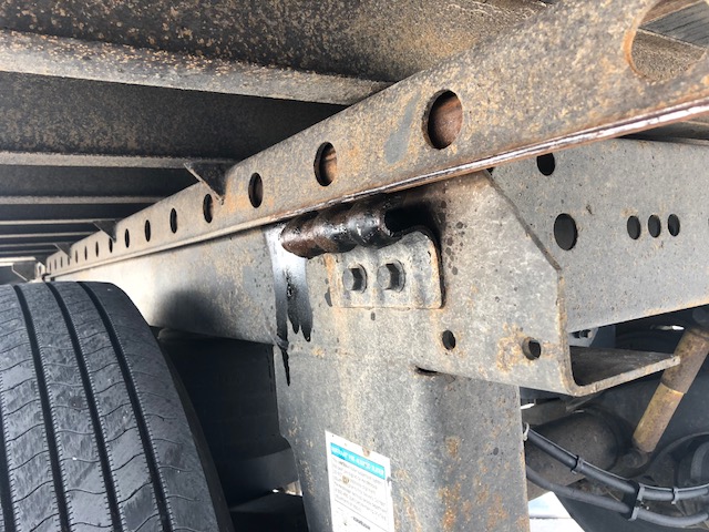

    And it is the primary reason those tandem pins are so recalcitrant. Every time a yard driver spins a trailer like that the torque on those pins is incredible.

    This actually easy to put back on the rail, Had to do that several times on trailers out of drop yards. This is what happens when you forget to lock in the pins and hit your brakes.
    If the pins are locked in spinning it in circles will not pull it off the track, but if you hit the brakes and the pins are not locked in, and maybe between the holes because you moved it unlocked then it will pop off just like the picture, if you loose those 2 bolts with a little gentle assist it will settle down onto the track put the bolts back in the bracket tighten it up and you should be good.

    a lot of places have you slide tandems all the way back and some drivers don't make sure that they are locked in as it would require walking an extra 100 feet which is too much work for some .. so it's not the yard dogs fault

    I agree the yard dog just moves what drivers leave, they also get blamed for trailers left to high , which the yard dog never has a reason to change.
